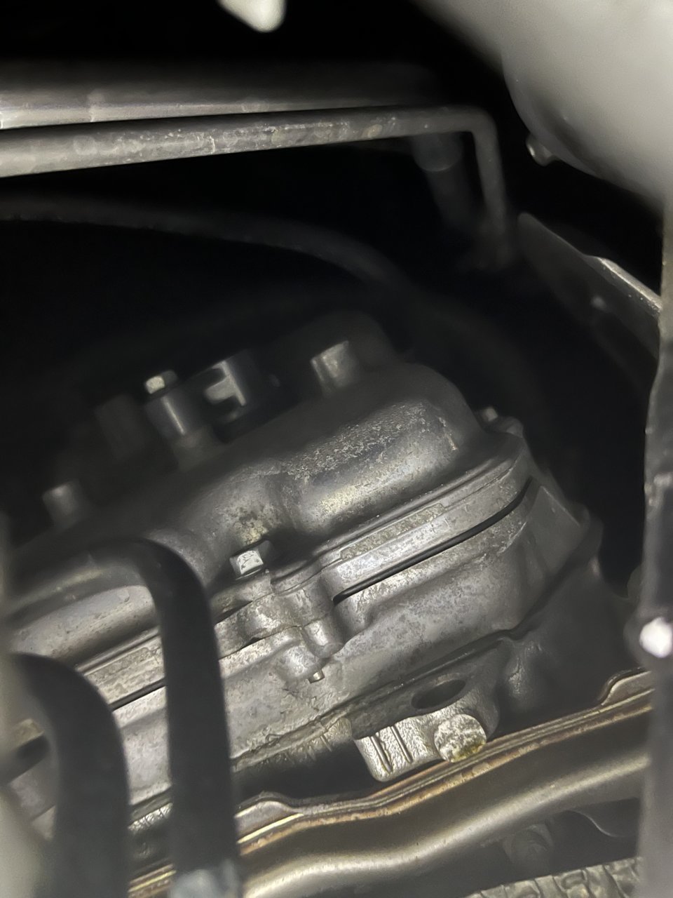

    My driverside is weeping and I get a small collection, of what appears to be a drip of oil that forms right on the rear cam tower. I monitor it and just wipe it off. Seems to collect in that area every 3000 miles or so. Obviously not a major issue and not tearing my engine down for it unless it gets worse. So far it’s been that way for approximately 20k. Here is the pic of what I get. Not much but noticeable if you look like me. Lol.
