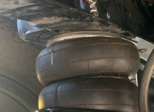

    So let me post with a caveat. I always am super particular and a little wary of mods unless it's absolutely perfect.
    The Negative.
    Anyway, installed Firestone ride rite with F3 wireless. Took so long to do and tested everything good.
    The total bummer is I guess when I did the final mount the ECU it was just a little too far away to make the bluetooth connection. It took me so long I'll have to wait awhile before I strip it all out and start over. SO.....Learn from me! haha.
    The Question is when the airbags were bolted to bottom bracket they seemed like they needed to be set inboard. Of course there is not this big of an adjustment. Really it only moves a little but not enough, that I can see to make a difference. Thought the cradles might help. But it didn't. Does this look right to you? Also I can't tell but maybe leaf springs are a little flat? Hard to believe since it's a '17. Thoughts?

    i have the ride rites with daystars and my airbags do not look bent like that. I'm not sure what would cause that other than an improper install. First I've seen that.

    The top mount looks to be 180 degrees out, as soon as I get back from lunch I will snap some pictures

    I thought the same thing but I couldn't get the post to line up and the little frame knobs to sit in the hole the other way. Crap , maybe it is.

    I thought those mounts were also side dependent which also might be the problem.

    Oh crap if it is I must have missed that. I didn't see anything labeled so I just went for it.

    I’m not sure what’s wrong with yours, but here’s mine705BE7DD-E872-40AD-BAAC-4CC8BAC697BB.jpgCA6D309E-8FF7-4D9A-BD36-22957C9ECB85.jpg

    Your plates sit flush with the inside...
    OP's does not...

    Yep, I see that now

    These are mine. Hope this helps.
    F8505690-9621-4B30-AF18-D7DDE2F457C2.jpg 2493A799-3068-49B9-A708-4098209D3354.jpg 349DA8A5-3D5F-4E2F-8012-BD1499844E68.jpg

    Yep I see the issue. Not sure how I did that. Ok easy fix.
    Thank you tremendously.

    Hey just a follow up. Was able to swap plates over thanks to your insight, help and suggestions. Now it looks right. Thank you again. Love this forum.
