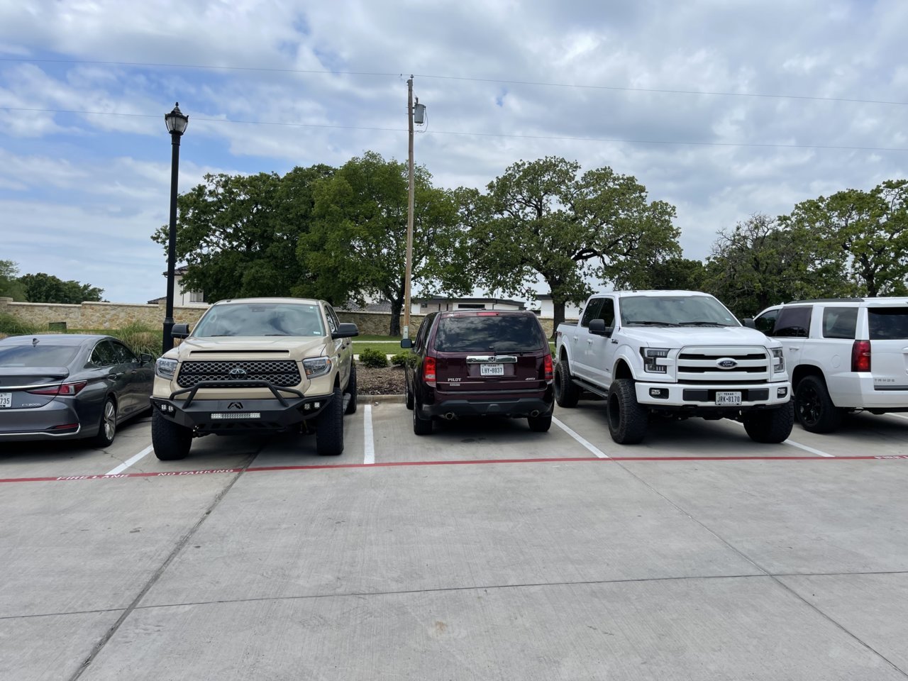

    1st tundra nautical blue 4x4 5.7l DC TRD had oracle custom color shift halo projector headlights, Fab4 bumper with 12k winch. RBP RX3 Grill Pro Comp stage 1 with bilstein 6112 coil overs SPC UCAs BFG KM3 35x12.5x20 with Moto metal 959s NFab running boards TRD LED DRL pioneer avh 4200nex with Polk speakers and JL 600w amp with JL audio stealth box 196k miles and running strong ready for another 200k until I wrecked it on 2/26/21 Just bought 2018 CM 4x4 5.7l quicksand TRD package upgraded headlights and adaptive CC Trifold bed cover, blacked out badges, KMC wheels BFG KO2 tires, 3/1 pro Comp lift FAB4 front bumper with rigid lights and fab4rear bumper.
    That’s my truck with a 3/1 pro Comp lift kit the previous owner installed. I wish he’d have opted for the 4/2. I just ordered a new set of BF KM3 in 295/70/18. Still debating on upgrading to the rough country full coil over 6” lift kit and going with 35/12.5/20 instead of the 295s
