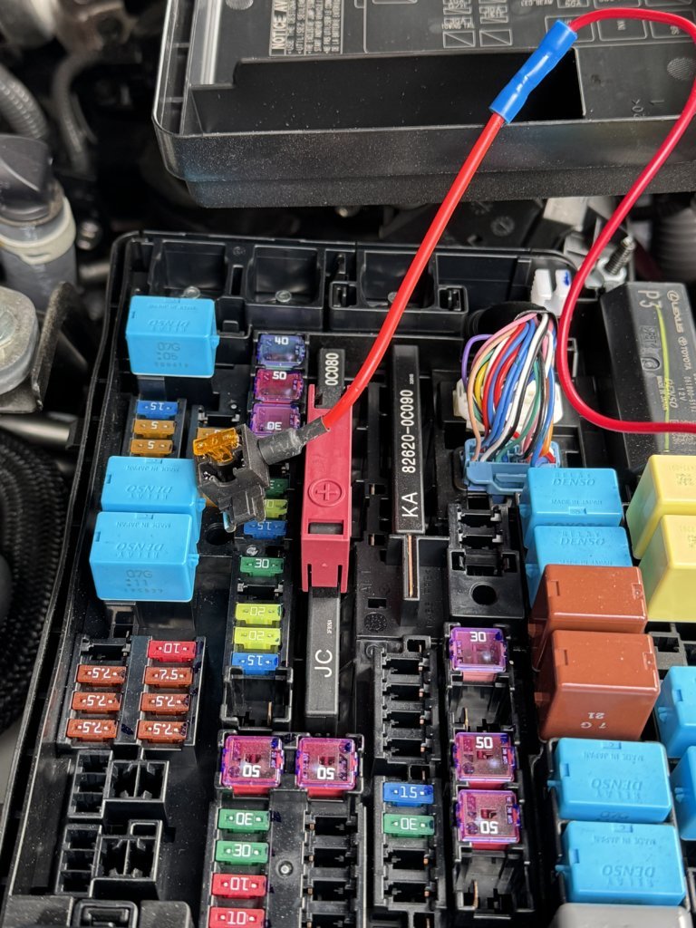

    I had a look at the Rave light bar and it appears to run off a 5 amp fuse and does not come with a relay so not necessary. That would make the install a bit more straight forward. If you got the square backlit switch, that will probably be the hardest part of the install. A multi meter will be an asset in this case. You will need to find the power for the switch light by taping into the wires in the area.
    Some guys have added a Taco Tunes fuse block to make adding more accessories a bit easier and cleaner.
    How you wire it really depends on how you want to control the light. You could have it triggered to a running light so when you turn on your lights it comes on as well. Or a separate switch to run it when you want. I think the factory light bar on TRD Pro only works when the high beams are on to avoid blinding oncoming traffic. You could use a fuse tap and have it on all the time! Just angle it down so it doesn't blind others.

    Thanks, just installed the marker lights. Working on the light bar now. Had to go buy fuse tap to do that instead of directly to battery. You got pic to where you tapped into the fuse box?

    this is where I plugged in my fuse tap. Shuts off when the truck is off.

    Wrong fuse tap type

    75
    ’24 Tundra 1794 Lunar Rock
    Well, that’s what came with the rave kit
    is there another empty spot for me to use?

    Did you read the instructions? Should tell you what fuse box to tap into

    -Place the add-a-fuse in a ENG IGR fuse slot in either the driver or passenger fuse box-
    I’ll try the driver side instead…
    should I disconnect the battery before wiring.
