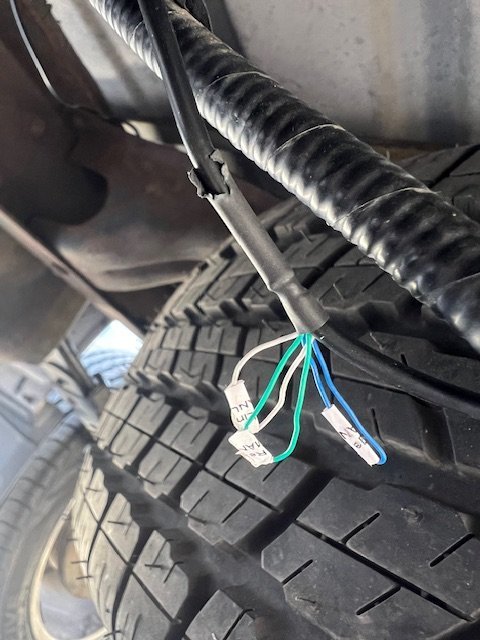

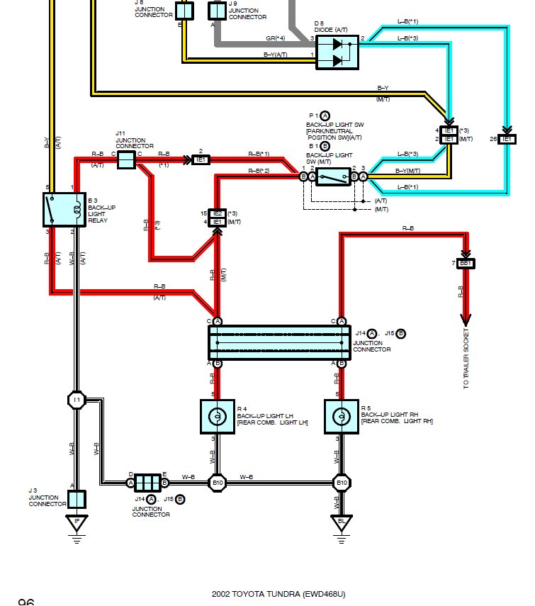

    I took the rear taillight out and blue with red stripe is the color wire shown in the diagram. but in the truck by the driver's side kick panel that color wire is dead whether in reverse or not. At the taillight blue with red stripe wire is 12V+ when ignition is on and truck is in reverse. The wire I'm trying to find in the cab is the reverse switch output to connect to my reverse camera. I don't want to connect at the taillight and run a 12 foot piece of wire

    All you need to do is tap the camera power along with that red wire onto the reverse tail light power at the back of the truck, then connect the other end of the wire to the radio's reverse trigger in the dash, and you're done (pic below showing the three common ways to manage it, depending on the wires that came with your camera).
    When you put the truck in reverse, the truck send power to the tail light, which then powers up the camera, and the same little red wire tells your radio, "Hey, I'm in reverse! Time to show the driver what's on the camera!".
    You absolutely do not need to tap into any wires inside the cab! Use the wire your camera manufacturer gave you.

    There are no extra input wires or ground wire with the cable that came with the camera, only a positive input wire at the radio end of the cable supplied, so radio trigger and camera positive has to be supplied up front in the cab somewhere. I assume the BOSS camera uses the RCA shield for its ground. Research reveals that the Alpine's violet white cable is the reverse input signal. So all connections with power have to be done inside of the cab.

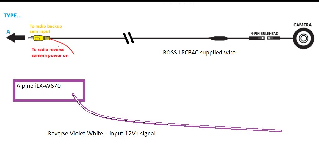

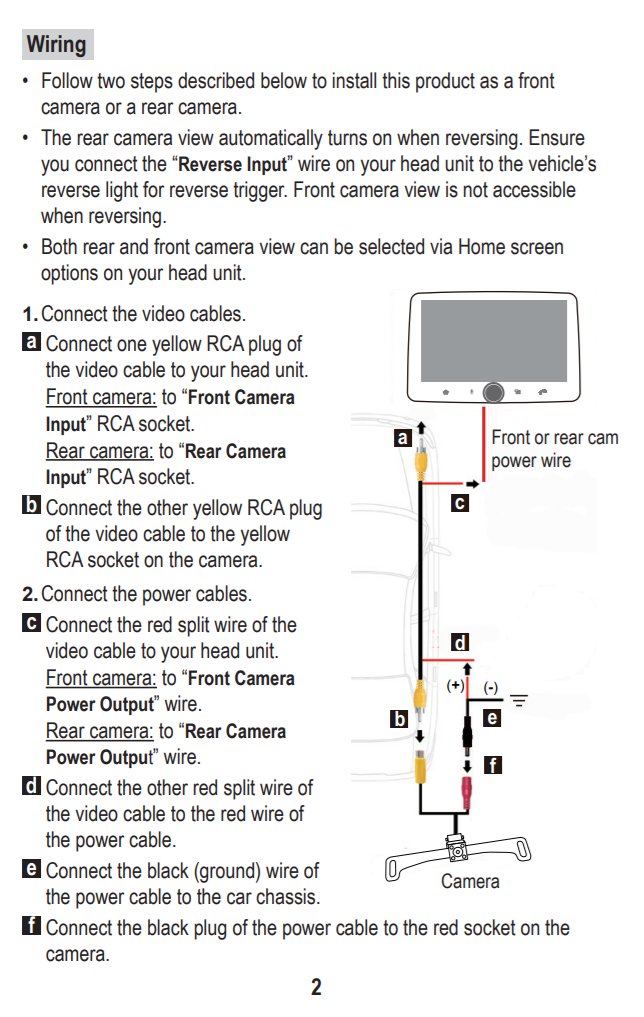

    Well, you need to contact BOSS, maybe you got defective product? Here's the install sheet for that exact camera you've just given the part number for: https://images.salsify.com/image/upload/s--SutX_XSk--/wxovgshrsy3vg6ybwbaj.pdf
    It clearly shows there is a turn-on lead combined with the camera, which runs the full length of the wire.
    See right here, on page 2 of the instruction manual for the camera I just linked. Note wire "C" and "D", which is the same wire, the turn on wire. They tie it together with the camera power wire, and ideally you would link that wire to your reverse light wire, in the rear of the truck.
    And note, their install shows the exact same as "Option C" in my picture. That is the correct way to install this camera, without needing to tap any wires in the cab.

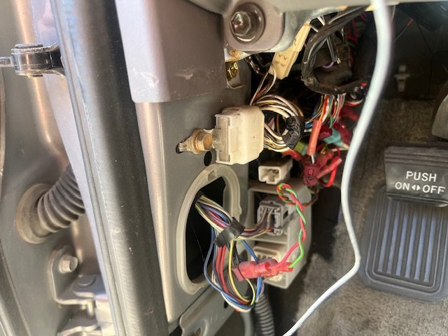

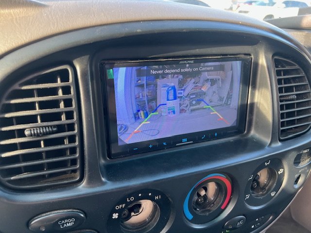

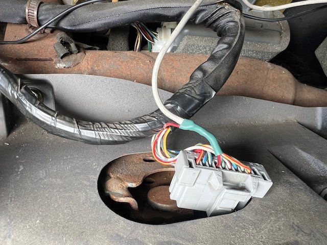

    Got the camera to work today, yesterday I tapped into the reverse dash light at the trucks cluster harness connection (red-black) and connected that to the violet-white of the Alpine and also to the red wire coming out of the Boss camera supplied RCA cable. When the truck was in reverse the radio sound would cut off but the screen went black! I was halfway there last night and quit for the evening. There is no red connector by the camera video input like what is shown in your diagram Thinking about the camera last night, looked for negative wire again this morning. There is no ground wire anywhere on the harness that came with the camera, there is a loop of blue, a loop of green and a loop of white. These are not explained on the Boss website not mentioned in the install booklet that came with the camera. I saw a video online explaining the the camera image could be flipped 180 degrees on your screen if you cut the white loop. Didn't touch any of the loops but peeled back the cable a little and saw a tiny black wire, cut insulation and grounded it and an image appeared on the radio when truck is in reverse only. So some progress was completed today, installed front door speakers and finished the under seat sub wiring sounds "full" but not boomy glass rattling or distorted, nice.

    All cameras have those loops, you either leave them intact or cut them, to change certain behaviors of the cameras. I linked you with their install doc above, it's clearly in the instructions, at the top of page 4 on the install sheet. Did you read the entire install sheet before install, like you should? It's right here:

    • With the purple Alpine wire attached to reverse trigger, it will automatically jump the screen to the camera input
    • If your camera doesn't have power, no video will be showing on that input, so you'll get a black screen
    I don't know how I can possibly make this any easier for you. BOSS gives you the instructions. If your product doesn't match what's in the instructions, that's a huge problem, and you shouldn't be installing it. If you can't find power wires, that's a problem. I think you're missing something somewhere.

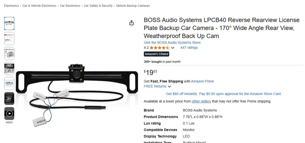

    Let me ask, because I went to scAmazon and looked this piece of shit up. Is this what you got in your box? The camera looks like this? (Former-installer rant: This is why fanatics and people who do this for a living hate cheap-shit products like BOSS. For $10 more, you can get a baseline camera from BOYO or NVX)

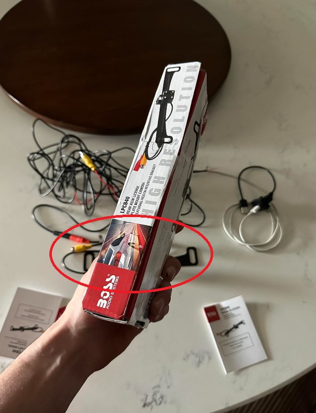

    I flipped thru the scAmazon reviews and found someone holding the box, with the camera in the background (see red oval). I clearly see, very near to the camera bracket, the yellow video connector and the red power connector (see left side of my oval), and clearly the product is correct because I see the box. Did yours come in the same box, or did you get a white-box item? (i.e. white-box counterfeit product, as would be soooo typical for scAmazon)

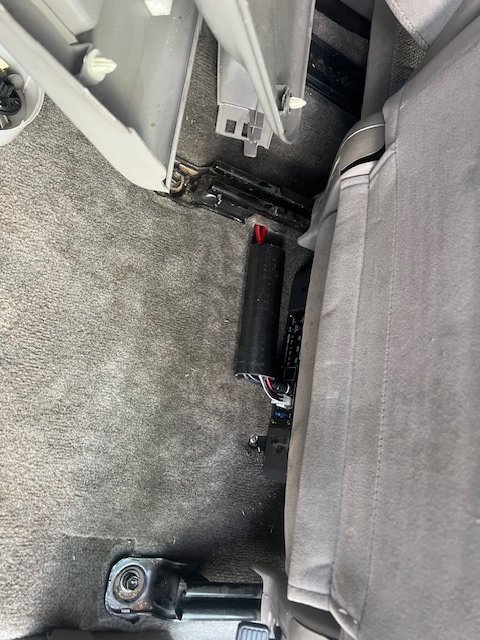

    ps8820,
    I'm keeping the budget (mostly) and buying open box and some used components.

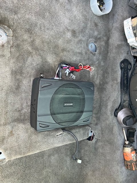

    The low power sub I used is a Rockville SS8P 8" slim under-seat active powered car/truck Subwoofer Sub. This is not a powerful sub woofer but just used it to fill out the sound. You would need 2 of these to really notice loud bass. They are self powered but with a 15 amp fuse I didn't expect or get much, you can "tune" it and set frequency, phase and boost but it has limited output without distortion, probably could buy another one and put it under the driver's seat if I really wanted more bass, I'm happy with it as is with slight adjustments.
    Stephen

    How'd you wire it in? Distortion is often a byproduct of bad `1v power transmission (too small gauge wire, poor grounding being the two biggies)

    Shifty,
    Have some electrical engineering I studied in college, was quite easy actually, power, ground, turn on wire and preamp cable run up to the Alpine HU. Used a metal snake to get back under the carpet. With the passenger seat removed it was no problem, pulled a rope back and forth with whatever wire I needed. Also ran a cigarette lighter socket for the back seat area while I was at it.
