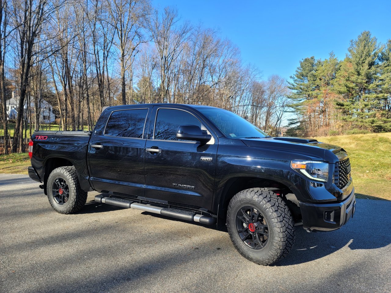

    Hello everyone! I just got my first 2021 toyota tundra trd pro. My first truck ever and love it!
    I decided to put on 295 70 18 nitto ridge grappler tires on and based on multiple youtbe videos, saying that those size tires dont rub. Mine are rubbing on the sway bar slightly... only on the passenger side. Does anyone have the same issue? Is there a way to fix it without adding spacers? Or should I go with 285 70 18? Lower? Thank you so much in advance!

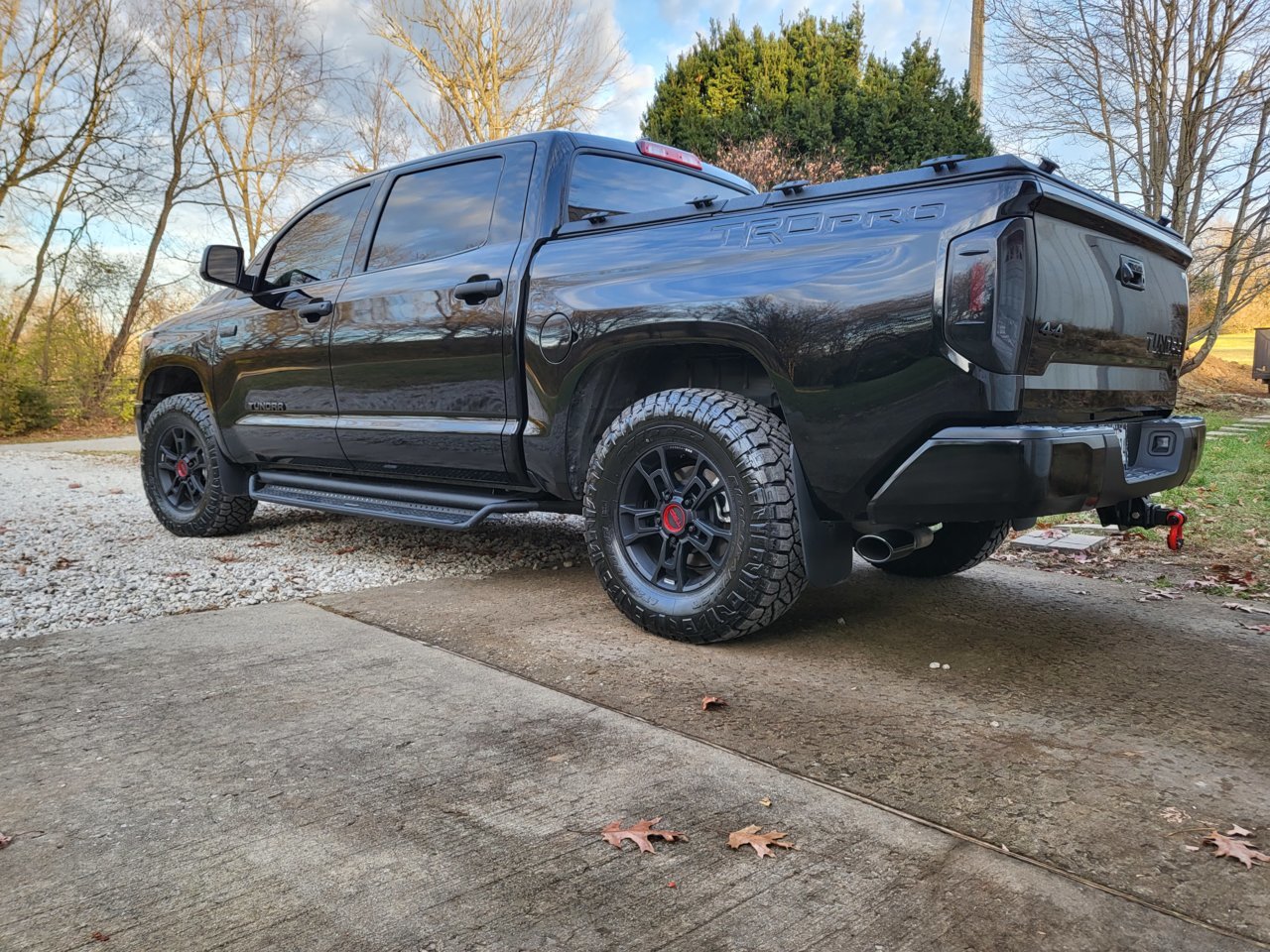

    I have a 21 trd pro as well, I also have the exact size ridge grappler. I haven't noticed any rubbing. I'll check thoroughly when the sun comes up. If they rub its so minor I can't tell.20211202_164051.jpg
    Hansito[OP] likes this.

    Thanks for the info! I was thinking perhaps shave the tires a bit to avoid the rubbing instead of the spacers.
    For some reason my passenger side tire is inward, and the right side pops out a tiny bit more. I'm guessing this is why is rubbing on the passenger side sway bar?
    Such an annoying and unessesary stress. Lol..
