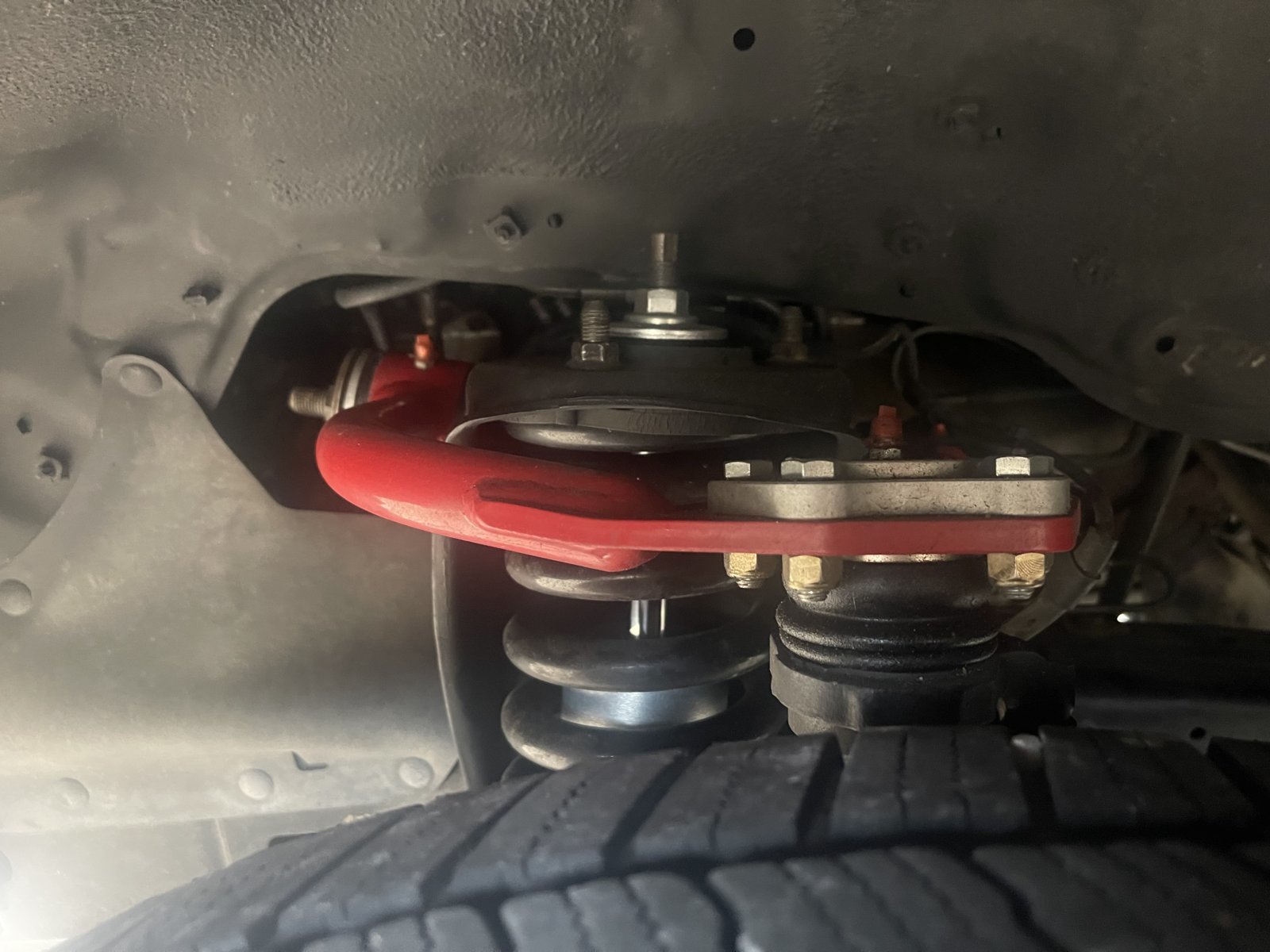

    In case anyone is having a similar problem, I'm following up on this thread now that I've got a little more experience with the issues
    What I found is that with these lifted vehicles with stiffer suspensions make certain your alignment shop sets the caster the same on both sides. Just being within the recommended tolerance from the factory is not sufficient when the suspension is stiffer. The caster on both sides was set within tolerance, but was not identical This is what caused the walk Bumping those 2883's up to the second perch on the bilstein's definitely made it too stiff for my liking, but the actual walk was from the unequal caster
    I'm happy I changed to the Dobinson springs. They're ever so slightly not as stiff, but the other contributing factor for the walk was the difference in caster from one side to the other. After installing the Dobinson's and a new alignment, I can still feel just a little bit of walk. It wasn't as scary but having the shop adjust the caster so both sides match corrected it.

    I believe @assassin10000 recommended 2.8
    However, once I went from the 2883's to the Dobinson Coils which put it at just over 1.5 inches of lift mine was well over 3 and I could not go any lower unless I got new aftermarket UCA's

    Over 3 is fine. I'd consider 2.5 a minimum if possible.
    Usually lifting gives less available caster. Thats why aftermarket UCA have extra built in.

    thanks. that's what I suspected but something just doesn't add up.
    once I changed the 2883's out for the Dobinson coils to get a little more lift while staying on the bottom perch of the 5100's (now about 1-1/2 to 1-3/4" of lift) they say the caster now cannot be adjusted down below about 3.4
    it sounds like the problem is normally the opposite
