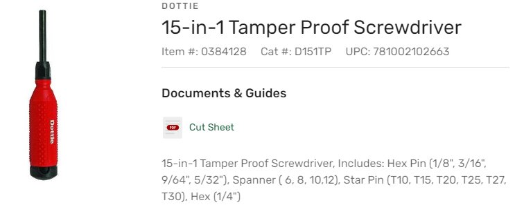

  7. Sep 29, 2023 at 9:27 AM

    Weagle[OP] and shifty`[QUOTED] like this.

    Thanks for the reminder. My side mirrors need tightening as well. Glad we have a few of these laying around.
