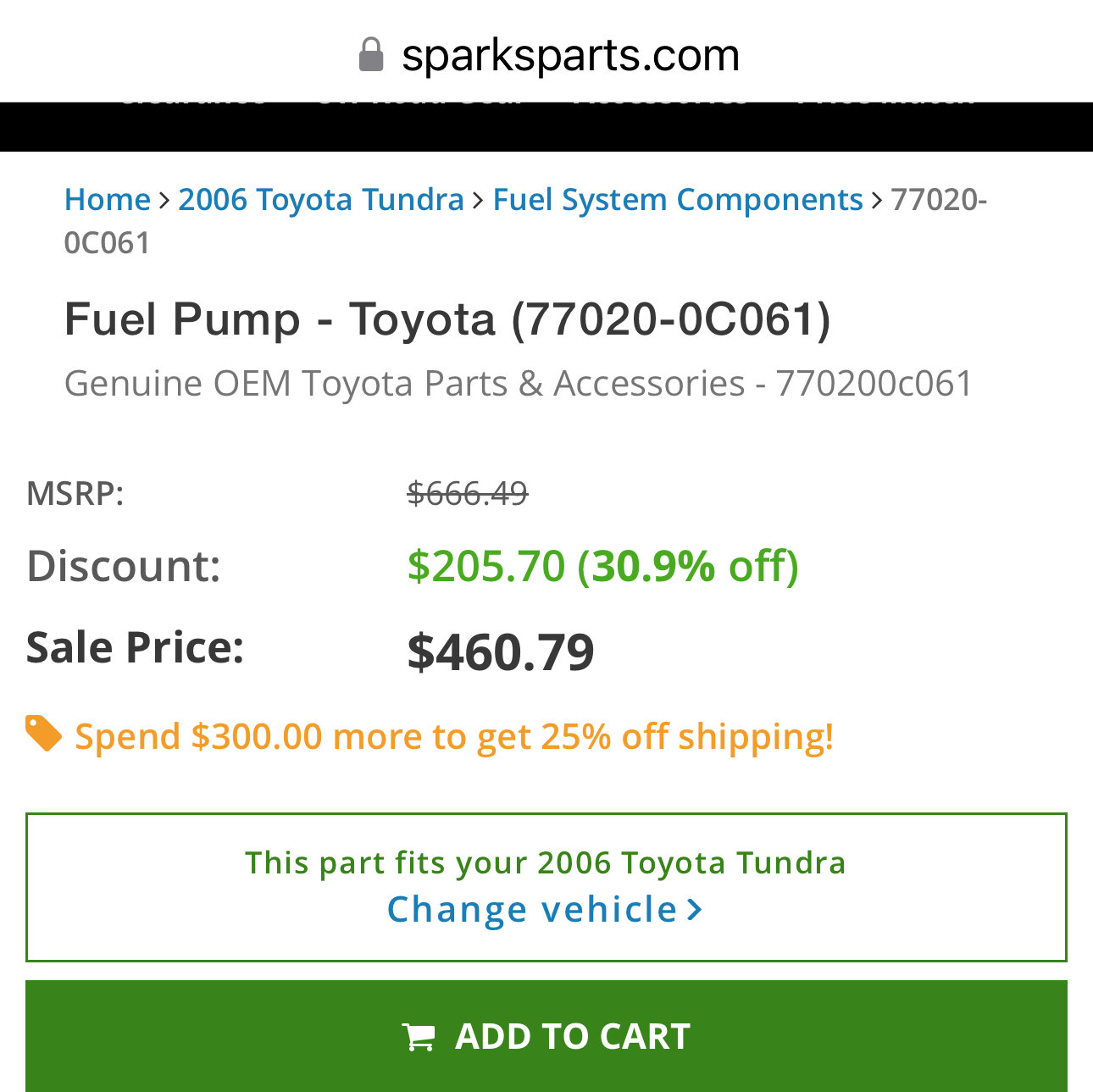

    1st peak at OEM:
    After a little More searching it appears around 450 is the going rate for OEM but I'm still searching

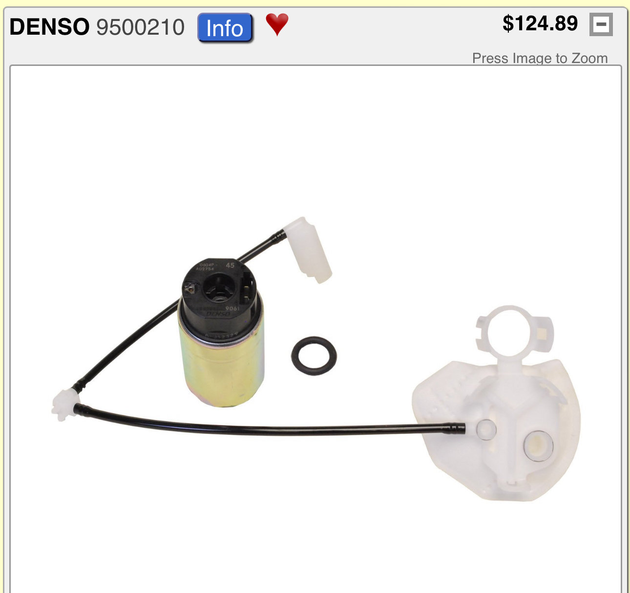

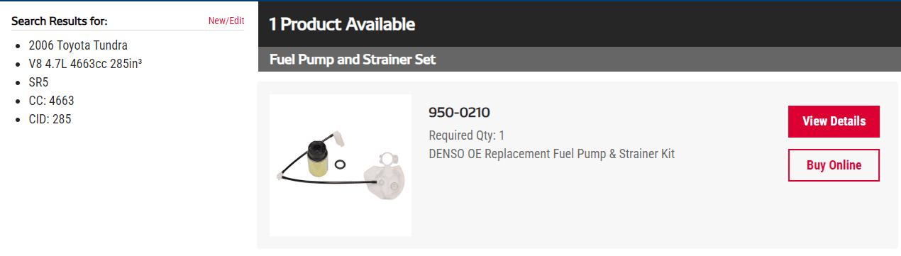

    Denso is this cheap? Doesn't seem right after looking at the other aftermarket products. Picture doesn't look right, but the description sounds correct

    Yup, that's about right.
    I always cross-reference my part numbers using the part lookup tool @ www.densoautoparts.com
    Once I have the part number, I'll run it thru RockAuto and Summit Racing to see who's got it cheaper after tax and shipping, and execute.

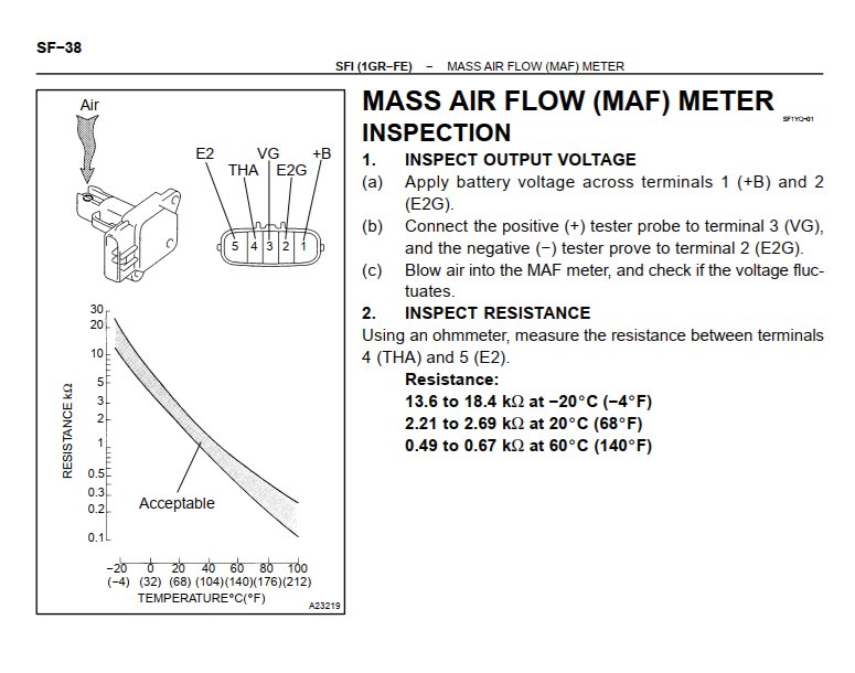

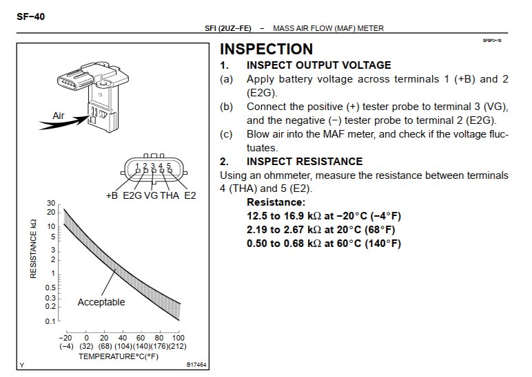

    Which reminds me, I still have this fully assembled white grille (minus Toyota emblem) For the 2005-2006 I need to do something with. They take up a lot of space.
    Anyway, from the FSM, testing the resistance on the MAF process. 1st pic is for the '05-'06 V8 but I'm also dropping the 2nd pic for the V6 in case someone with the V6 stumbles upon this later. Note the graph that gives you the approximate resistance range based on temp.
    For the V8 / 2UZ-FE:
    For the V6 / 1GR-FE:

    Shifty, thanks. That is great info on troubleshooting the MAF. I Should be able to do that in the next few days

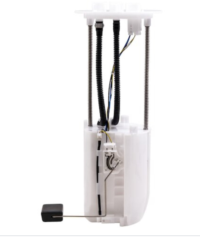

    speaking of Denso my only concern with that price I got is the Denso does not have as many parts as the OEM or others I've seen online. Now I recognize lots of times they use stock pictures that may not be accurate but the Denso that I found that is supposed to fit just looks much simpler
    Denso:
    OEM or similar:

    Stock images are not always correct.
    Additionally, what you're seeing is in the 2nd pic is a fuel pump assembly. The 1st pic it just the pump, where you'd pull the assembly, remove the pump from the assembly, then install the assembly.
    I haven't done this job specifically on a 1st gen Tundra, but I've installed my fair share of fuel pumps, both replacing OEM, and into aluminum fuel cells (usually Walbro, they make a great pump), and the little cylinder is the actual pump-pump.
    Will you get the full assembly if you order OEM? I am not sure. But the only time you really need to replace the assembly is if the sender is flaky, i.e. you've got a dead spot in the float/slide that sends resistance back to the gas gauge.
    It looks like the part number you pulled truly is the valid part for your truck. If you want to replace the whole assembly, OEM may be the way. You'll be forking out some coin though.
