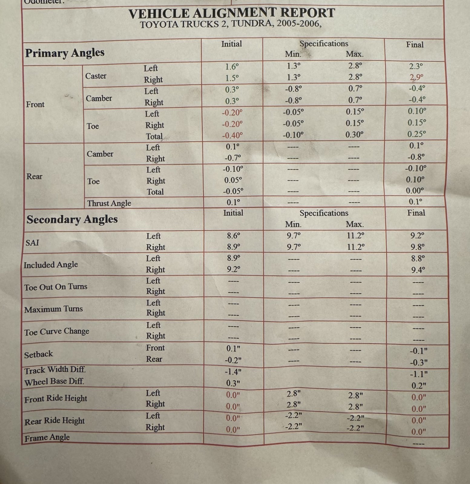

    I just took another look at the alignment specs from today. It's an improvement And I know they struggled with it a little bit, but I did I have concerns over a few of these numbers.
    @assassin10000 is that difference in caster between the left and right side enough to cause concern?

    .6° off side to side isn't good but not terrible. If you're not getting any pull, then I wouldn't worry too much (hands off steering wheel, flat road at 45+ and it goes to the left or right too fast).
    Many cars come with a .8° or 1.0° side to side split.

    So far, that's what I've experienced so suspected it was OK. But I'll know better after driving a little bit more this weekend
    PS @assassin10000 my shop was impressed and they took notes for future alignments with lifted tundras

    if I had known all of this, I would've gone ahead and replaced the springs. I was just going on what Josh at 1stgen said. And before reading this thread, I was pretty sure I had mostly read the first or second perch was OK just do not go to the third or fourth. But now that I know I'll take care of that next year
    My measurement from center hub to the bottom of the flare was originally about 20 inches which is in line with others that I've read. With the 2883's it was roughly 20-7/8". Now it is 21-7/8". And I'm sure with my measurements there is about a quarter inch margin of error in either direction
    As always, I appreciate everyone's advice and insights. Incredible experience and help on these forums. I either learn something new every time or learn how little I know

    Well, it's obvious it had a negative effect on mine. But what I described in this thread so far is the only thing I've noticed negative.
    but it is enough I would spend a few hundred dollars to get more appropriate springs
    And like I said, I appreciate you and everyone's insight. Helps me learn
