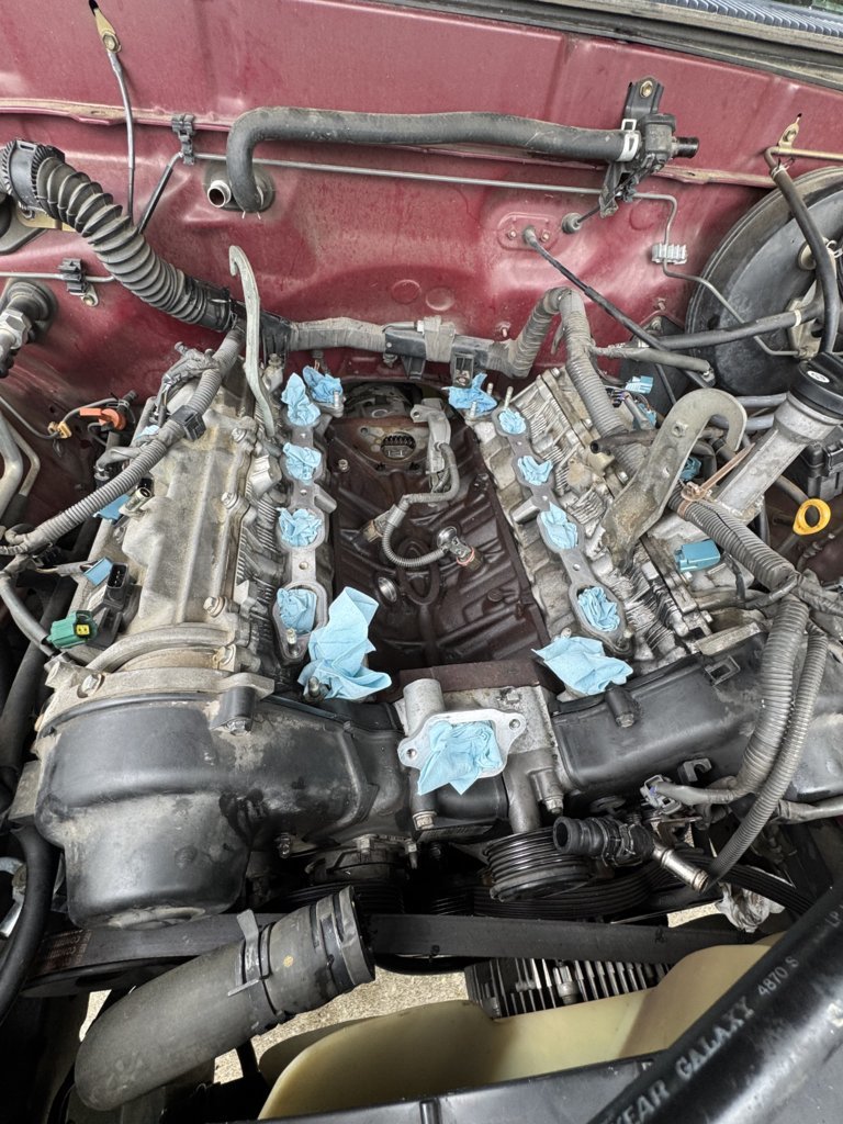

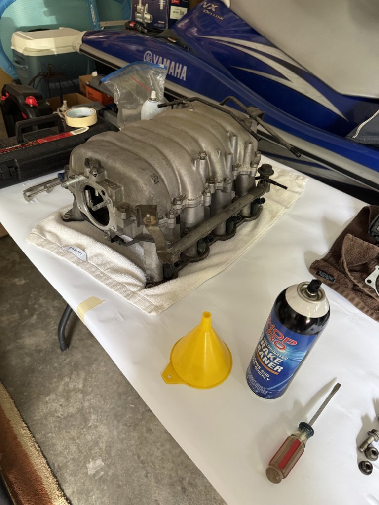

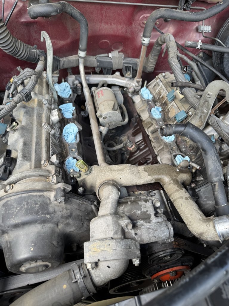

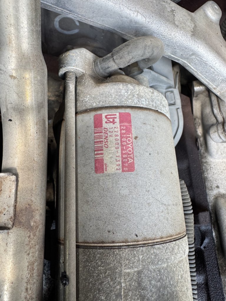

    Began disaaembly after work. Got a couple hours work done and then got chased away by a thunderstorm. Going slow and taking lots of photos.

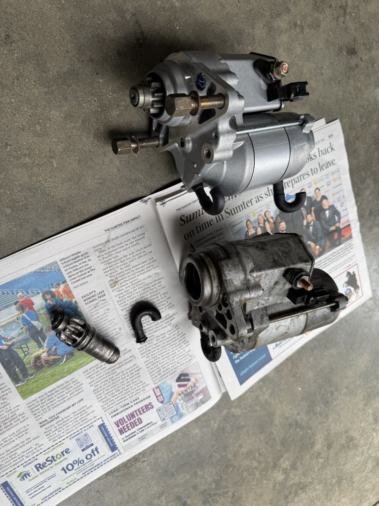

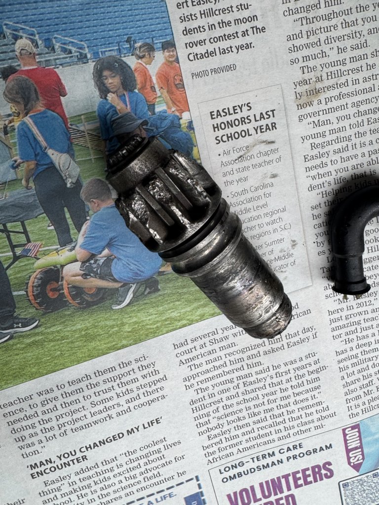

    well the starter had definitely grenaded. The new Denso from RA has a slightly different back of the motor but looks like it should fit. According to my VIN I don’t have the cold weather package. Not sure.

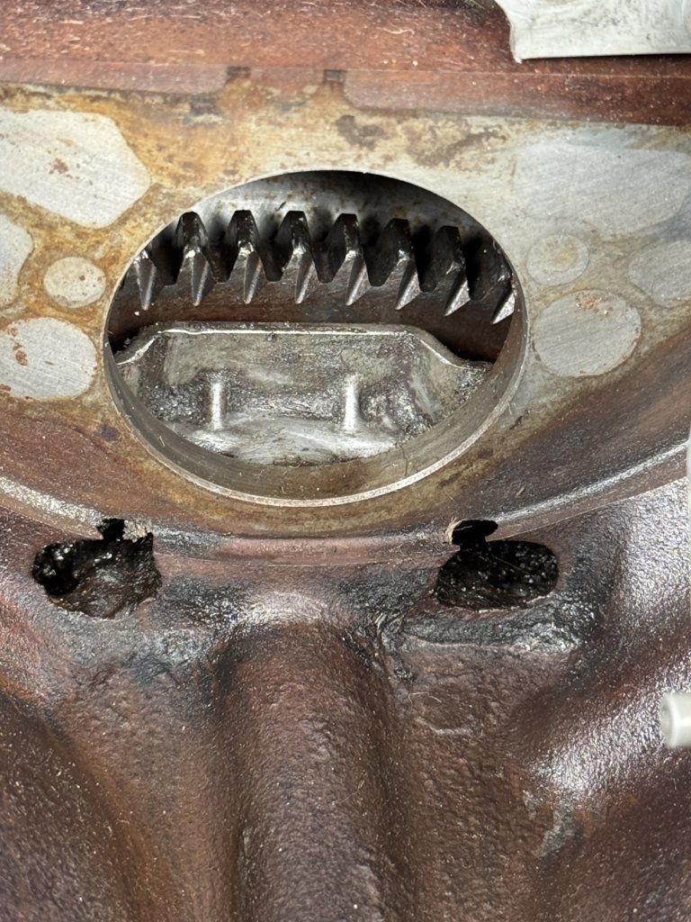

    Teeth on the flywheel ring gear have some small dings but appear serviceable

    Cleaned everything up but unfortunately the connector on the starter trigger wire crumbled from 25 years of heat. Same thing happened to the grey temp sender and evac switch connectors so I ordered some new ones and have to wait to repin starter wire before installing starter

    '06 AC Limited V8/4WD

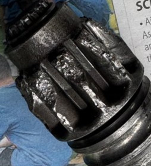

    Ouch. Almost looks like the bendix got stuck out or bounced out and got put in check by the flywheel.

    2018 SR-5 CM 5.7, 2000 SR-5 AC 4.7L
    @shifty` - the entire shaft was separated from the motor. Never seen such a failure. Oh well, it gave me 250,000+ miles of good service and I needed an excuse to pull the intake to do the crossovers which both had slow weeps. I only wish I had ordered some new connector for the starter and knock sensors ahead of time. 25 years in the south takes its toll on rubber and plastic.
