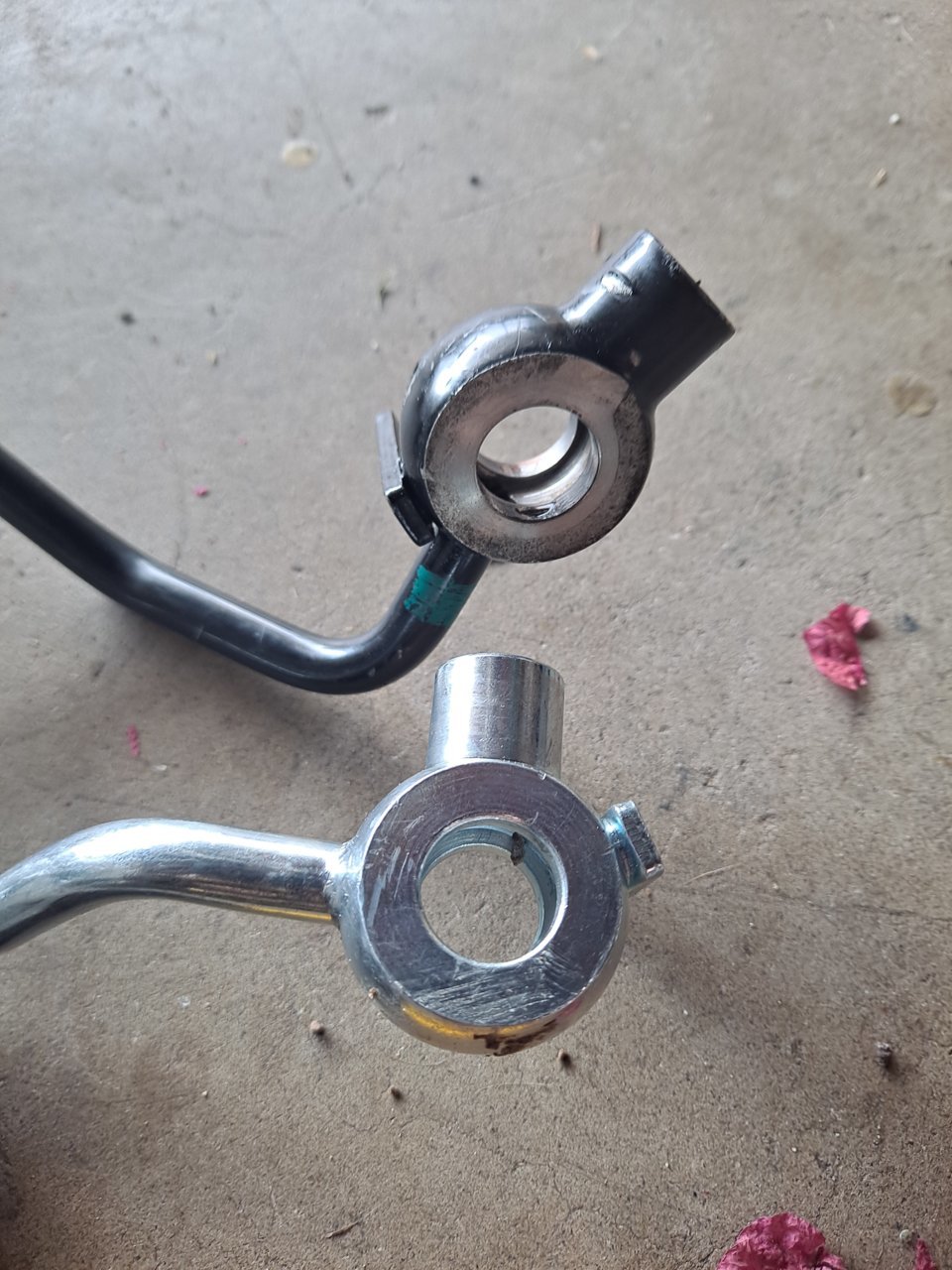

    Be careful with buying products from Rock Auto. I got a power steering pump and ps pressure line. Both were the wrong type.
    I have no clue why the line itself would go out. I'm assuming you've tried using OEM lines.
    Rock Auto lines for my Tundra were too short. The new line is silver and the old one is black. Not trying to make this about my issue, I just wouldn't want you to go through the process of getting a part and it not matching. OEM is expensive, but if it has a warranty on it, just replace it when it goes out. Easier said than done
