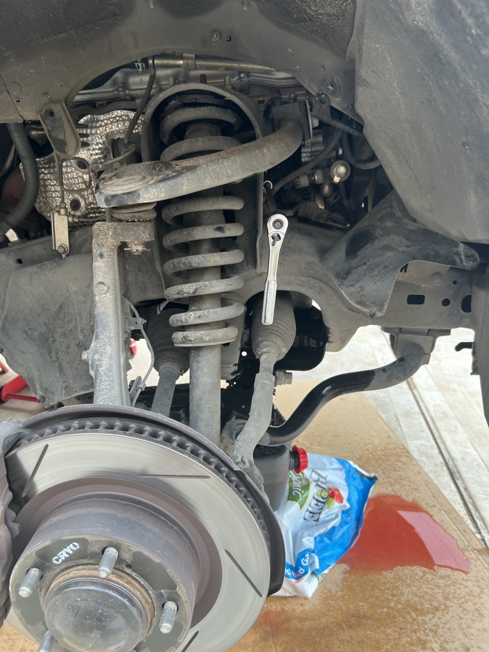

    Here is where to access the passenger side 10 mm block drain bolt on a 2008 Tundra 5.7 Limited 4WD with towing package.
