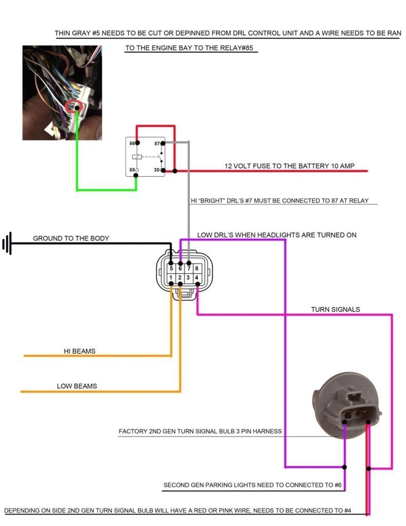

    I’m almost done with this upgrade. The headlights, fill panels, and an adapter harness harness are the minimum re quirked. There are a couple of threads with various bits of info on the ins and outs of swapping the lights, the grill, and the fill panels. Here is wiring diagram if you want to make your own adapter harness or try and re-pin. I’ll post the username of the original source when I dig it up again, I did not design this.
    blenton likes this.

    That’s awesome! I wasn’t sure if you needed the harness, a controller, both, or in your case - you can make you own. I may have to study the diagram..
