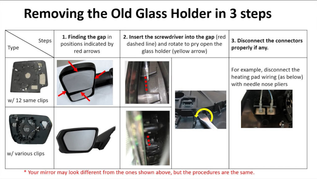

    Hello.
    I just purchased replacement glass for my mirrors. I have taken off the old mirror just fine. I have this housing unit that clamps back into the mirror unit itself. I am having trouble taking this off. Any suggestions? I’ve tried YouTube and haven’t had much luck.
    The second picture are “directions” on what I’m supposed to do.

    This is the way to do it if they are OEM Toyota housings and mirrors.
    https://www.youtube.com/watch?v=uMxqTIG1nWY
    Aftermarket mirrors may/may not fit; some of them are made for aftermarket housings, not all of which are compatible with Toyota OEM units.
    I bought my Tundra used, and it had one OEM housing and mirror and one aftermarket housing and mirror. I monkeyed around with them for a long time before realizing they were different and not at all compatible with the mirrors I bought. I ended up ordering a used OEM housing and mirror from Ebay.
