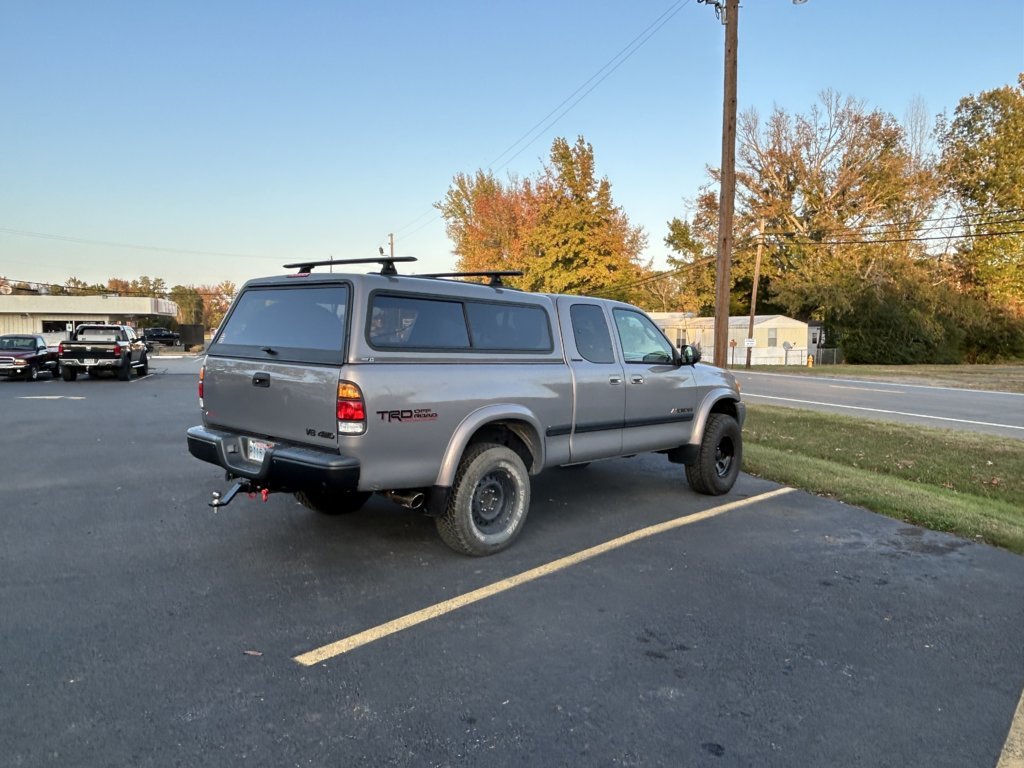

    Finally joined the club. With the help of the pre-purchase guide on here I just bought a well maintained 2000 4WD Access Cab. Utterly in Love. It came with the full maintenance records.
    Question:
    The timing belt was replaced at 90k miles in 2016. The truck currently only has 124k miles. Obviously the new belt is well under its 90k but it is coming up on nine years.
    Does it need to be replaced based on age alone? It looks fine to me, no cracks etc, but should I take the truck to a mechanic to take a better look?
