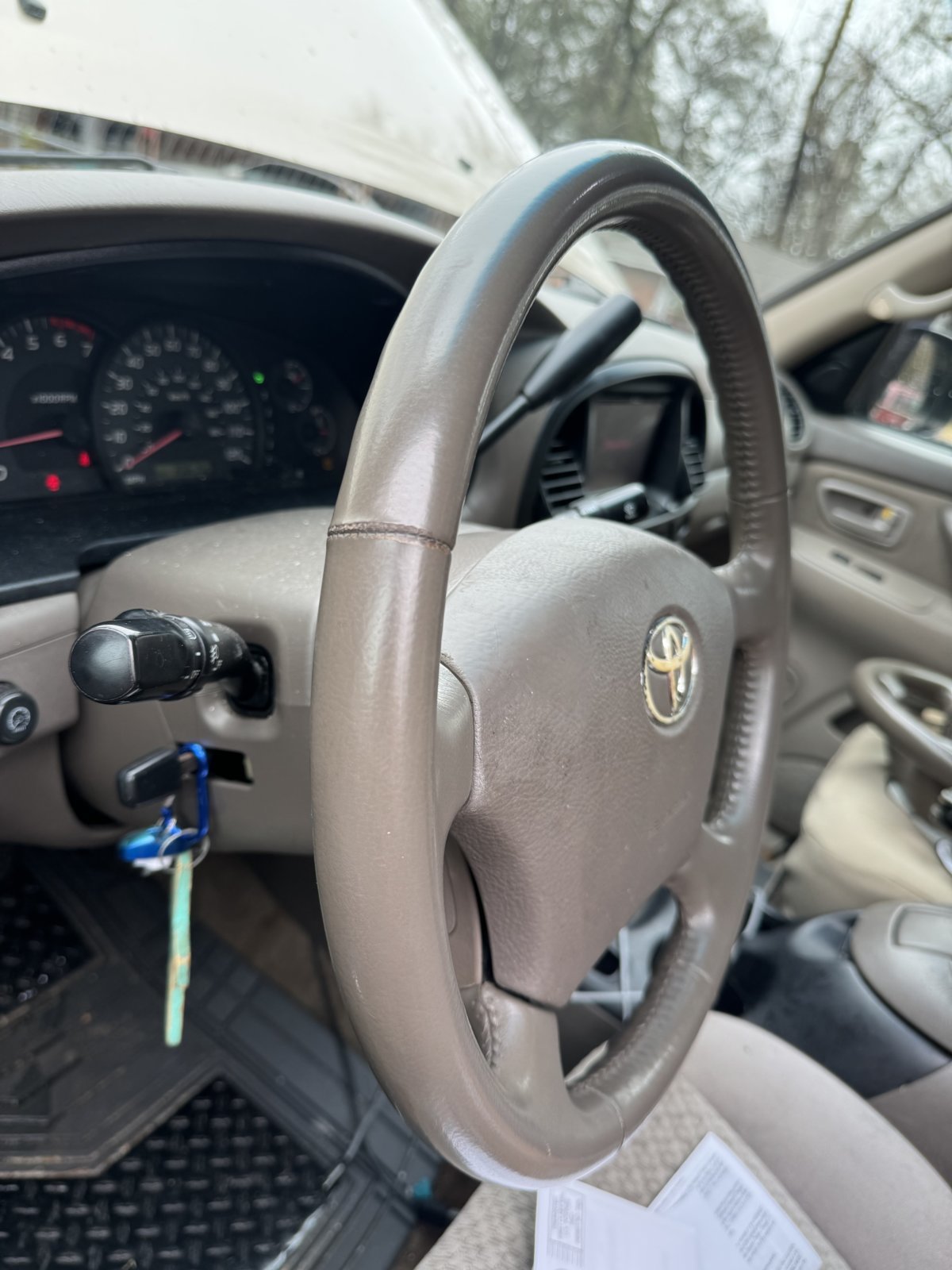

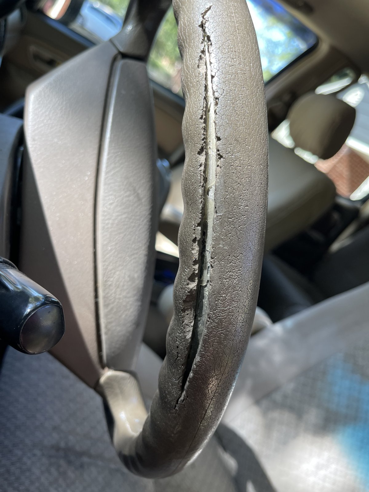

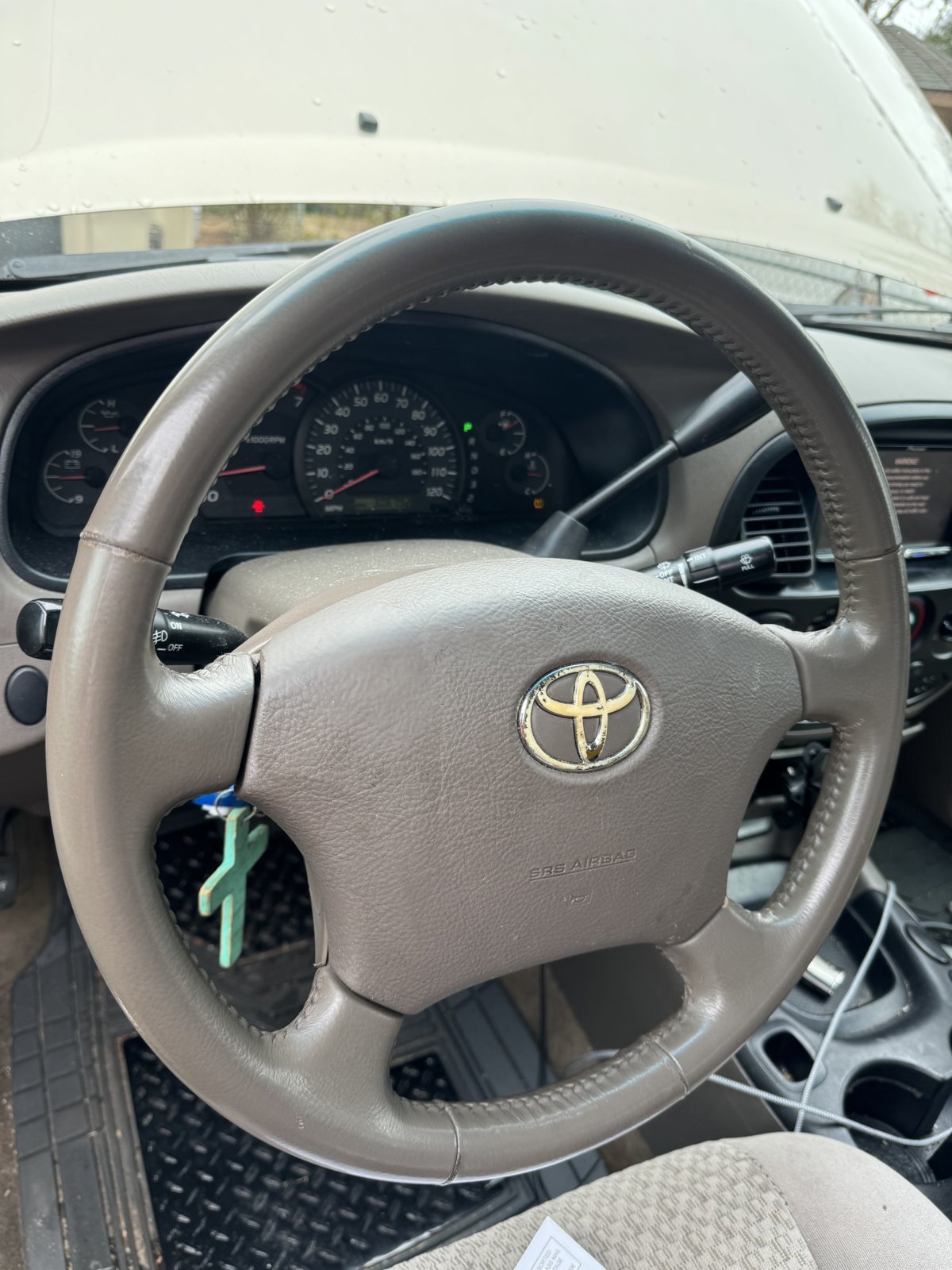

    thanks @shifty, got my old worn out and torn steering wheel replaced with the leather steering wheel from a sequoia today. Took less than an hour counting the time to discharge after disconnecting the battery
    Unfortunately, I've got to go back in because apparently I did not align it correctly and now the steering wheel is turned quite left to keep it straight. I am sure it wasn't like this before. I went through great lengths to ensure I had it aligned properly, or so I thought
    I didn't bother with the radio controls since I would either have to have a different horn/airbag assembly or cut the existing one. I'll worry about that another day. I couldn't tell if it was prewired since both old and new wheel's connectors plugged into the same size wiring connector from the steering column
    This was quite easy. And like you I was easily able to remove the steering wheel without the removal tool. Not sure why I dreaded this little project so much. Thanks for the help
    also ordered one of those Toyota emblem overlays off of eBay. I saw where they weren't being made anymore so I hope this is legitimate and works. only $19.
    Old:
    New leather from Sequoia:

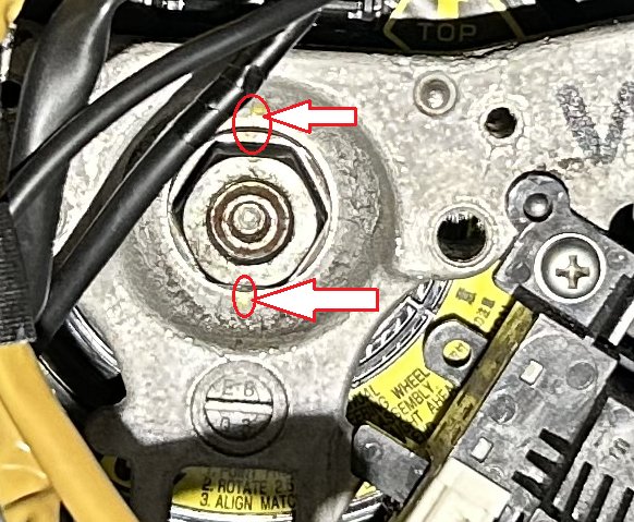

    Yeah, it doesn't show well, but ... if you look at this pic, you may notice a faint yellow mark at 12 and 6 o'clock on the wheel itself, it's washed out on the center post of the column though. A couple of things I always do when I know I need to remove steering wheel:
    • Start car, straighten up the wheels, jiggle the wheel back/forth to center it, then turn off car.
    • Neg battery cable pull, wait 5-10 mins.
    • Remove airbag, mark steering wheel and its fastener bolt at 12 and 6 o'clock so the position of the wheel is known, both on the wheel and the bolt, at least within a tooth or so.
    I pretty much do the latter of those three on anything I'm removing & need to keep track of where it's positioned, like for steering wheels and rag joints, or where it's tightened to, like for tie rod ends, or to monitor for back-out, like on lower ball joint bolts. Take a paint marker and mark a position on the fastener and part. Doing this, it's hard to screw up re-assembly.
    If I were you, and you're positive you reinstalled the wheel 'off', I'd straighten up the front wheels to parallel, remove neg batt cable, remove the airbag, mark 12 o'clock position only on its flanged post/bolt (and only if the wheels are still straight), then line up the wheel as close to the proper position as you can.
    My wheel has always been maybe one tooth off, and I've never gone in to fix it, nor brought it up during an alignment (b/c I have no idea if it's the wheel or alignment or what). But generally speaking it's pretty straight.

    Here's a close-up shot. You actually can kinda see both marks at the 12 position, but the one at the 6 position isn't too visible because of the top nut.
    Only need to mark it once on the center shaft and it's good for as long as it lasts!
