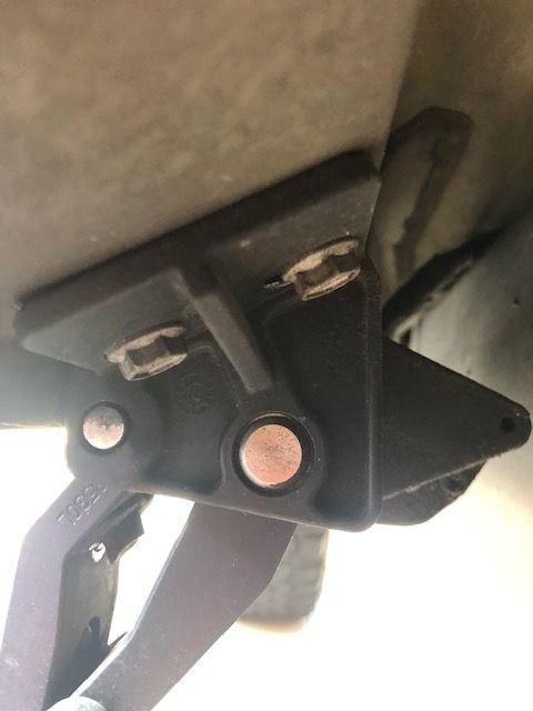

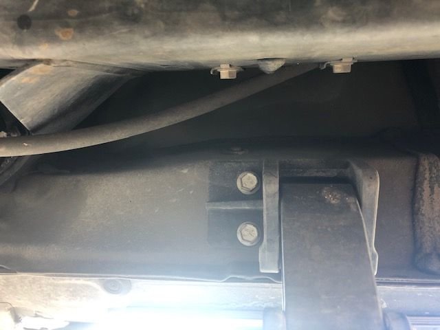

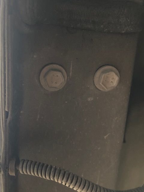

    They have no other purpose than to bolt on steps from what I remember when installing my amp steps.
    My amps steps only have 2 brackets, my OEM tubes had 3.
    I just got under the truck and I see I have bolts in the unused holes.
    So those where from the OEM tubes.
    I tried to sell my OEM steps, then I tried to give them away, and in the end, I put them out for trash pickup after being in my garage for year.
    I would try to thread one back in the hole and stop if it bottoms out.
    If not, stick them back in.
    Only reason I can see to put them back in would be to keep the holes clean in case you want to install different steps in the future..
    But as you stated, if you sell your steps, you probably want to include the bolts.
    If you just want the holes plugged up, buy some shorter bolts, they shouldn't be too hard to find..
