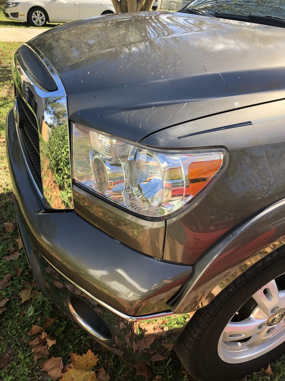

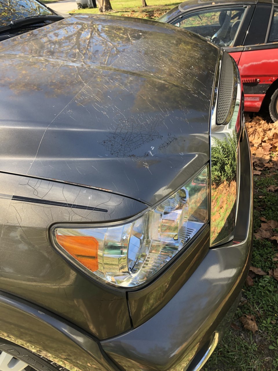

    what is the best way to remove the factory clear protective bra from the hood? I started peeling it but it just breaks apart. I tried spraying goo gone on it and still it doesn’t do much. Anyone have a better method? Maybe heat gun or something similar? I added some pictures of what mine is currently doing and what it looks like.

    Heat. Then maybe a 3M eraser wheel

    My film guy uses a steamer. There is minimal glue residue left on the surface after he lifts the film.

    I assume the film has a life span and that’s why it’s falling apart during removal. Similar toa wrap probably 5 years. Good luck, the steamer sounds like a good idea.

    I used a hair dryer on my decals to remove them. Worked great but I did this just a few months after I purchased.

    Steamer, hair dryer or heat gun. I use wd40 for the adhesive and it works amazingly well.
