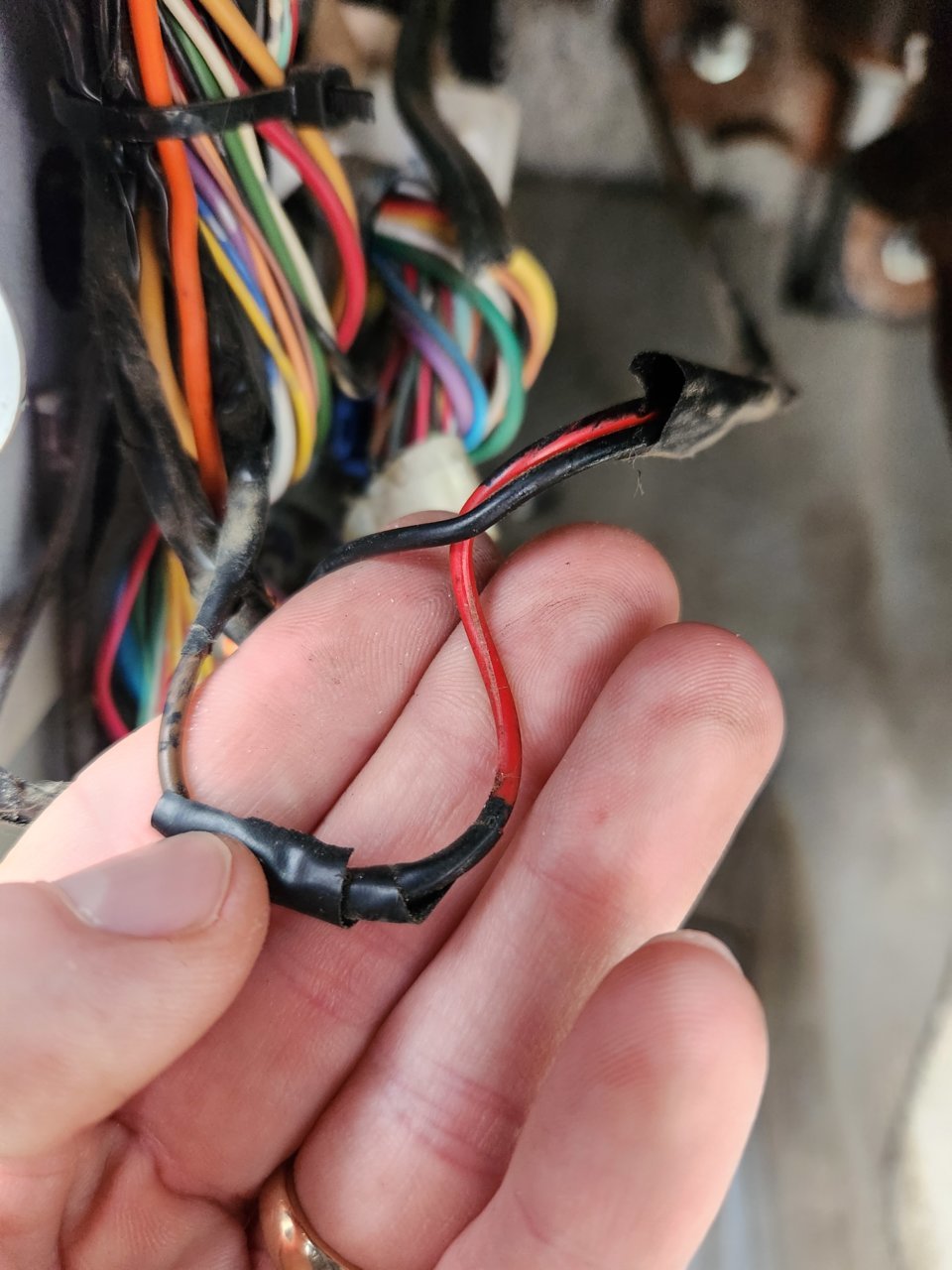

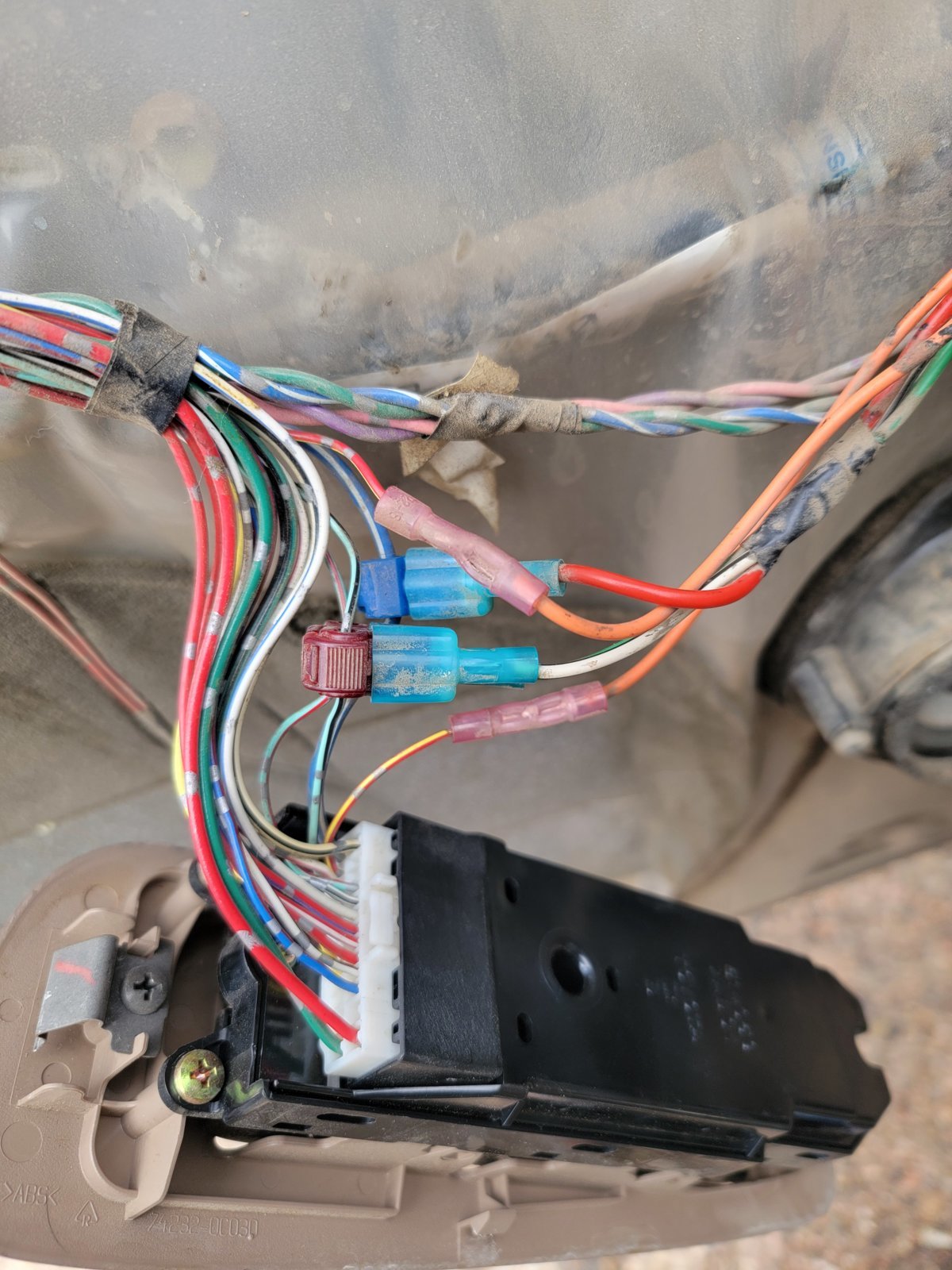

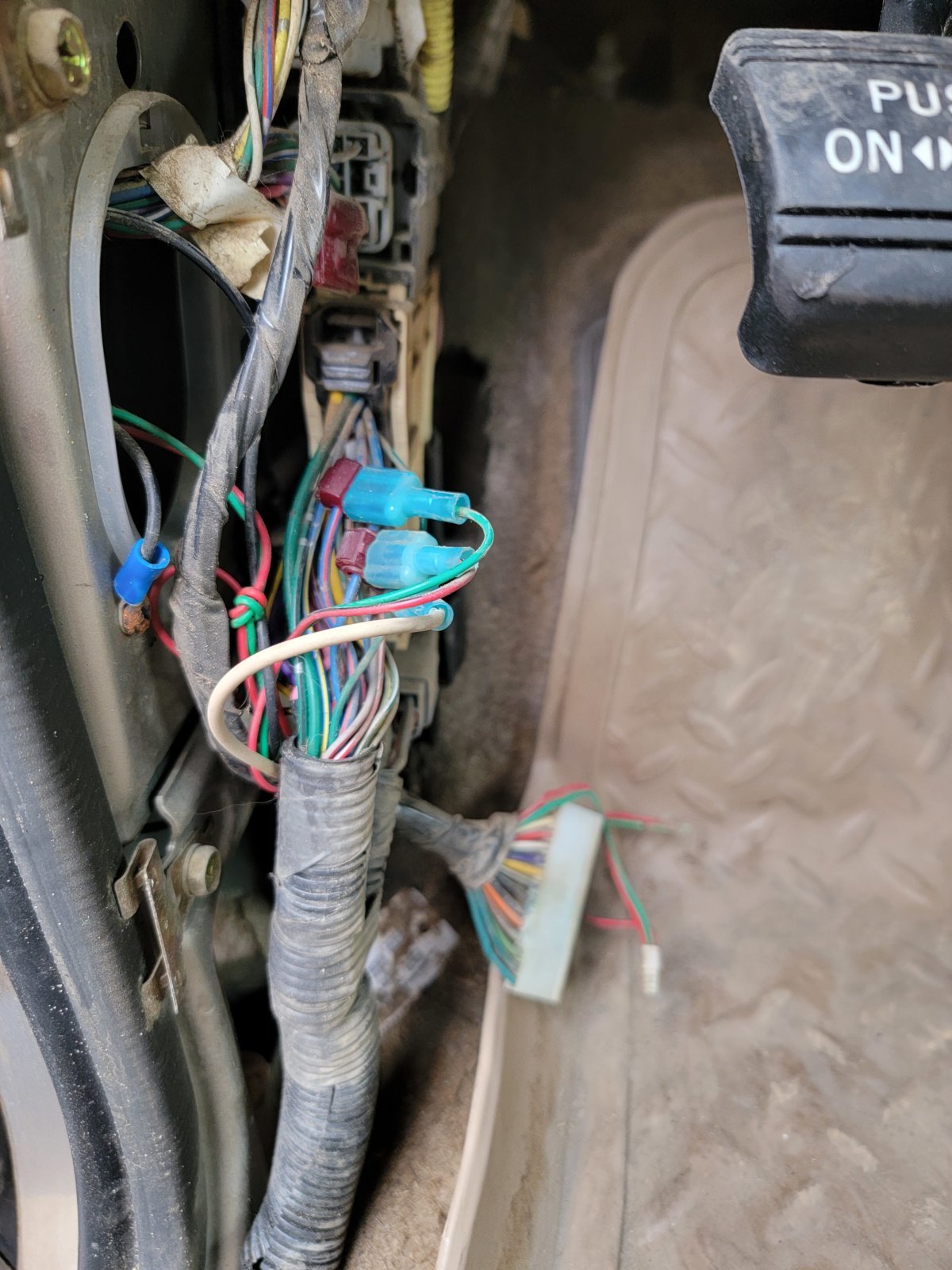

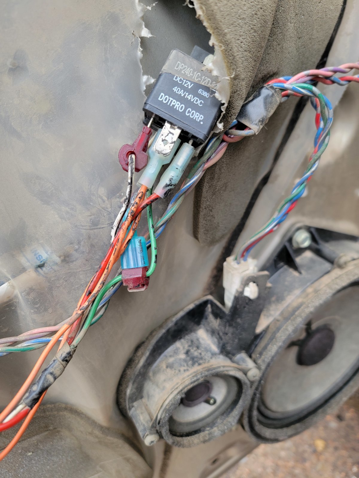

    Hey everyone. I have scoured other posts and the wiring diagrams. I am having issues removing a troublesome aftermarket alarm from my 07. The dilemma I'm now having it figuring out where this brown wire goes. The truck will run now but the dash will blink, click and trigger the 4 ways. The high beam are also disabled. Someone help! It comes out above the parking brake and runs up near the steering wheel then back into a bundle of wires that leads into the firewall.

    You need to put the red/yellow back together, undo those taps and get that relay out of there. If you are looking to remove that thing.
