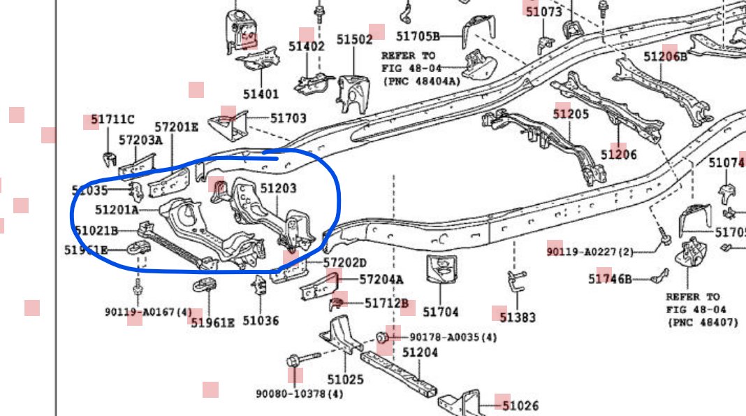

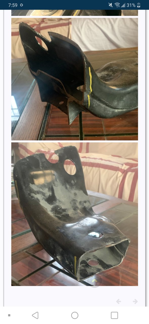

    Good evening all. I just got an 08 tundra crew max 4x4 with a 6" procomp lift kit that I want to take back down to stock. I've seen a couple posts about the crossmember cutout and am wondering if there's anyone that may have the cutout piece taking up space somewhere and/or the stock differential brackets that they wouldn't mind parting with. Please let me know. Thanks so much.
    I added a screenshot from a similar post talking about rewelding the cut piece

    You can actually buy the the OEM crossmember from Toyota, couple hundred bucks. Would need to be welded on.

    Guess I was wrong on the cost. It's a throwaway part when it's cut out.
