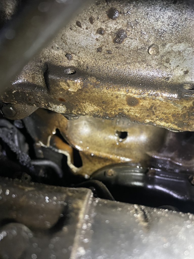

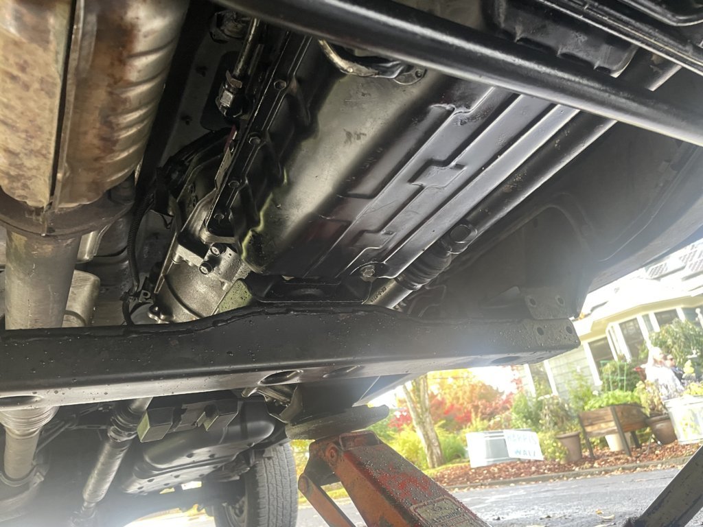

    Here is the holes and the truck. I turned the engine today and nothing happened except for as a certain point in the crank I could hear the piston that was closest to the whole hissing. It sounded like a healthy hissing of a piston with good compression.

    I see what looks to be the lowest part of a bellhousing and bit of a transmission. And that transmission looks to have some large chunks missing from its housing (and not the pan)?
    Weagle likes this.

    Think the image is looking the other way. Towards the motor and that’s the lower and upper oil pan, right?
    whodatschrome[QUOTED] and Weagle like this.

    Yup, you’re right. I must have been holding my phone backwards when i was looking at that pic.

    Is the hole an innie, or an outtie?
    Did something come out of the pan, or did something go into the pan? Should be able to determine between these two by the hole yes?

    I don’t know how to determine entry or exit by the hole.

    Any bits bent inwards out outwards? Maybe not on the cast section, but on the steel?
