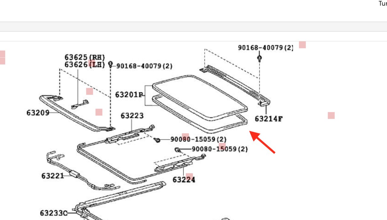

    Anyone ever figure out a source for the seal/weatherstripping? Mine does its job but I think the fact that it is 18 years old is causing an annoying flapping/wind noise at highway speeds when it is wet. Would love to replace it.
