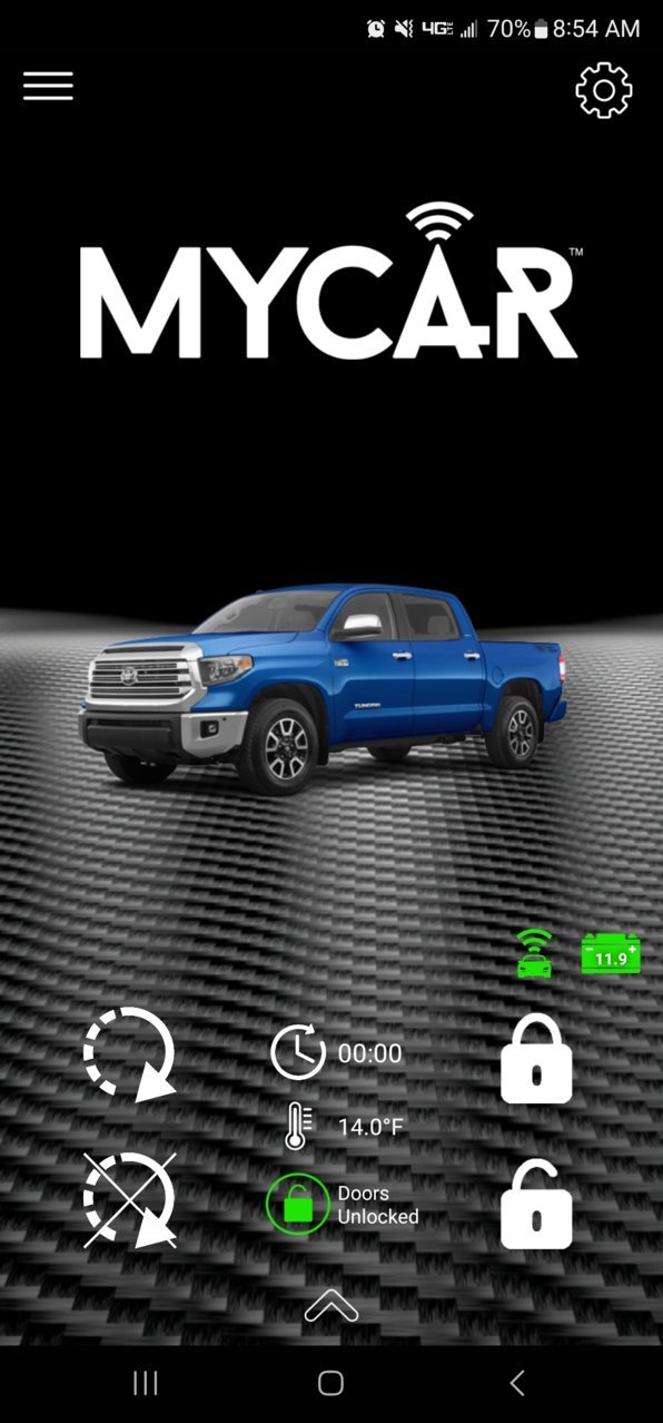

    I've had the CM-DC3 installed for a few months now. No complaints except the wireless carplay handoff can be a little clunky on occasion. No issues when connecting via bluetooth without carplay, FWIW. I still need to do a little more investigating and see if I can figure out a solution there.
    I went with the cellular option, which comes with a year of service, and then a few bucks a months from then on. Worth noting that the vehicle will remote start with the key fob regardless of cellular option being enabled or not. The selling point for myself was the immobilizer bypass. I'm sure some won't find it worth it, but to me it was. Remote start the truck, then hop in (with the key) and simply put it in gear and give off.
    As for install, I'd say intermediate in difficulty. There are over a dozen splices and connections to be made, with nearly all the wires being very small gauge, so difficult to work with if not well versed with wiring. Goes without saying, but you won't want to be goofing up any of these connections or you'll risk damaging a module that could cost big money. Hopefully with a little time they will come up with a plug and play option, although I have a feeling those connectors going into the various ECUs will be difficult to source, and potentially a cost prohibitive endeavour for the seller.
    Screenshot of the app homepage (also shows truck location, not pictured) :
    gnc1017 likes this.

    same screen as mycarcontrols app. just renewed our yearly sub for another $40. remote start + gps location (2 minute between refresh). alot cheaper than what drone mobile charges for just adding gps.
