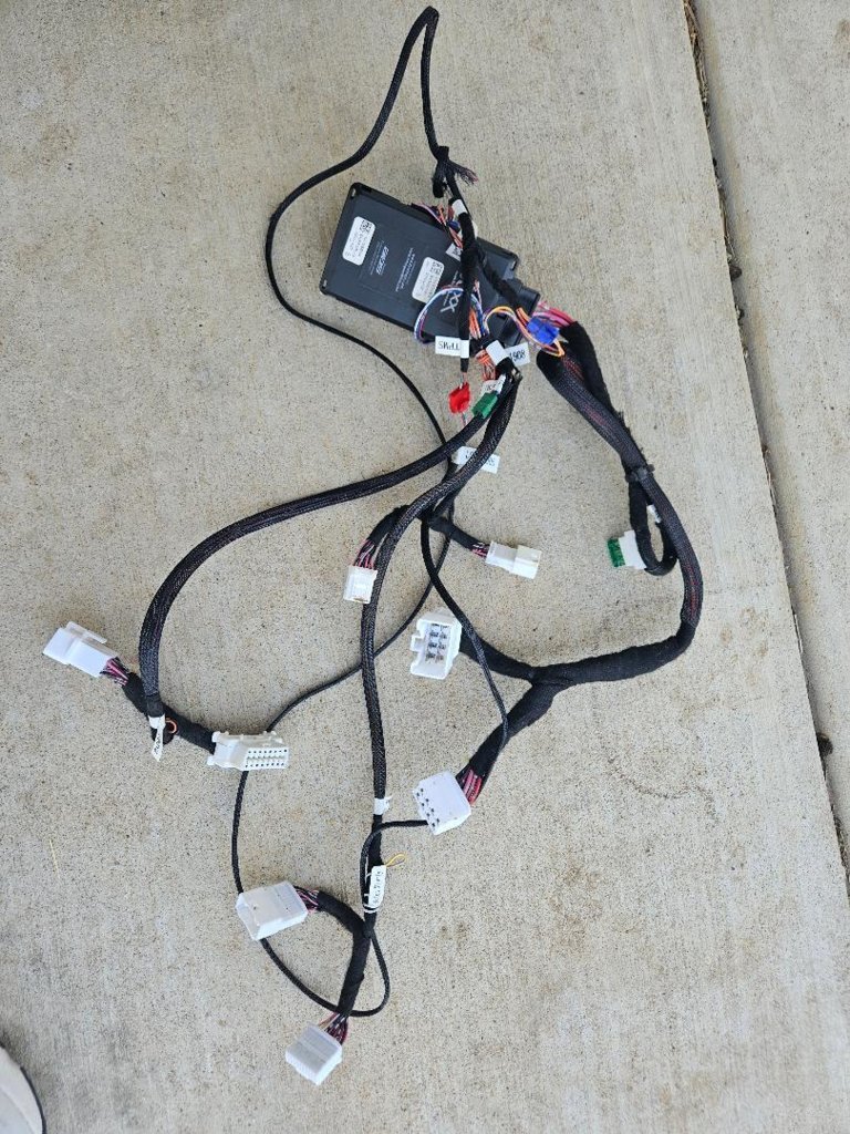

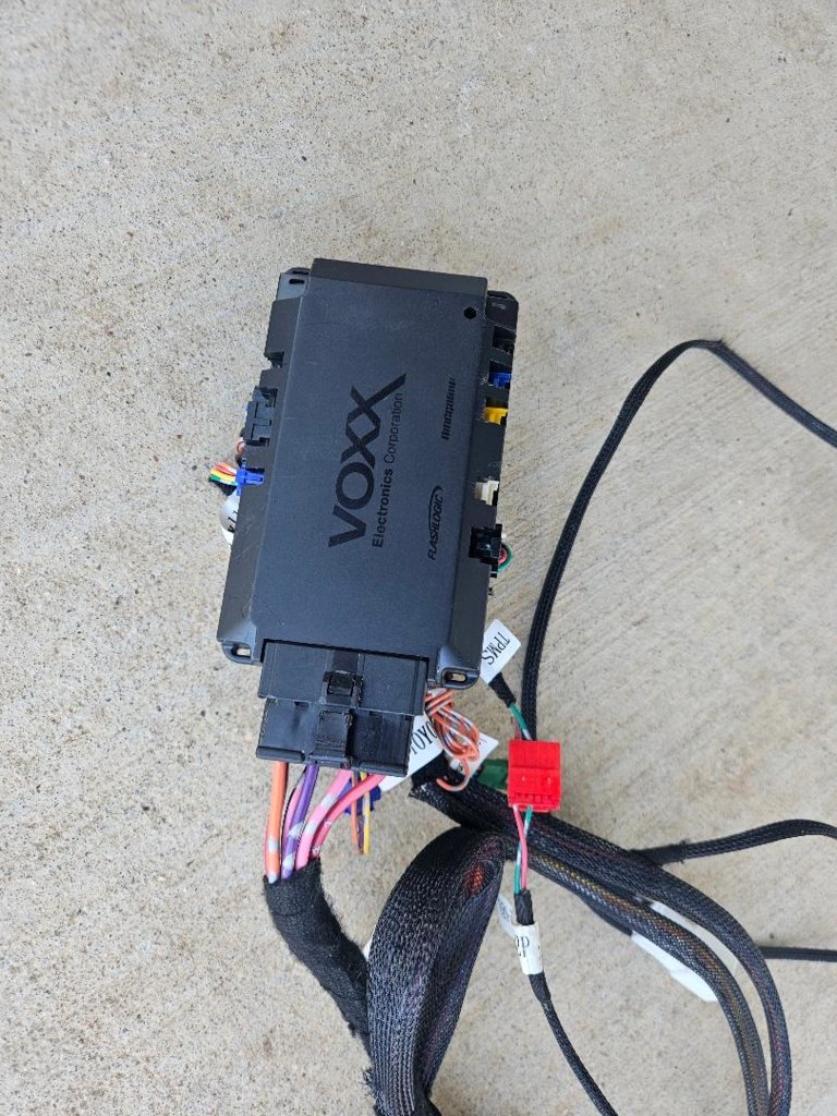

    12V systems hardware2.jpg My 16 Tundra had been blowing the 7.5A "AM2" fuse. Started about 4 months ago. I would replace the fuse and be on my way and the truck would start and run. Then, it started blowing them more frequently, so we replaced the starter with an OEM. Much quieter, but then it took about a month and the fuses blew again, culminating in not being able to keep a fuse at all, even without trying to start the truck.
    About 4.5 years ago, I installed a remote start system from 12Vsolutions.com. Seemed to work good and I was really happy with it, until now. I decided to remove that system today and the fuse no longer blew. So my only guess is that the module (wireless component?) that has the word "VOXX" on it, is likely toast. After removing it, the fuse no longer blows and the truck starts. So something about that system was majorly defective. Can't get the company on the phone at all (tried all day) and there seems to be nothing online about these things failing in this way. But I can say that if this item was going to fail, it should simply stop responding and no longer auto-start the truck. How it feeds back into that AM2 circuit is a mystery, but when it fails, it should definitely not cause issues like this....
    Hope this helps someone.
