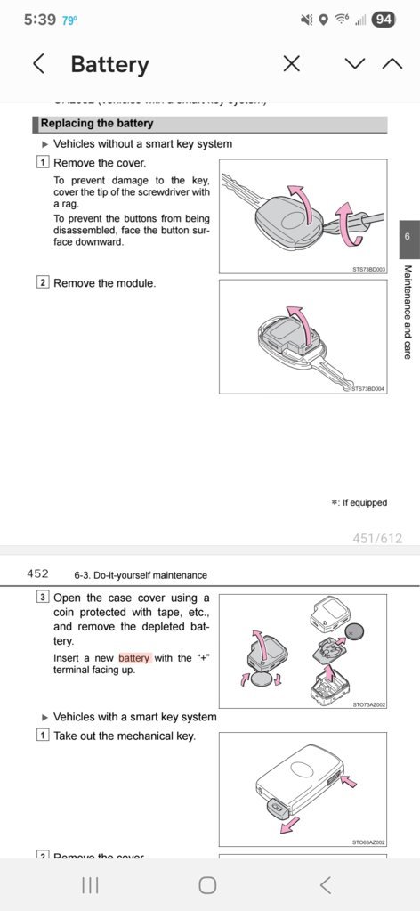

    The basic key remote on my 21 SR5 Tundra is giving out. Can the battery be replaced as I have never seen guts like the one in the current factory remote. Thanks

    Unless you have something different
