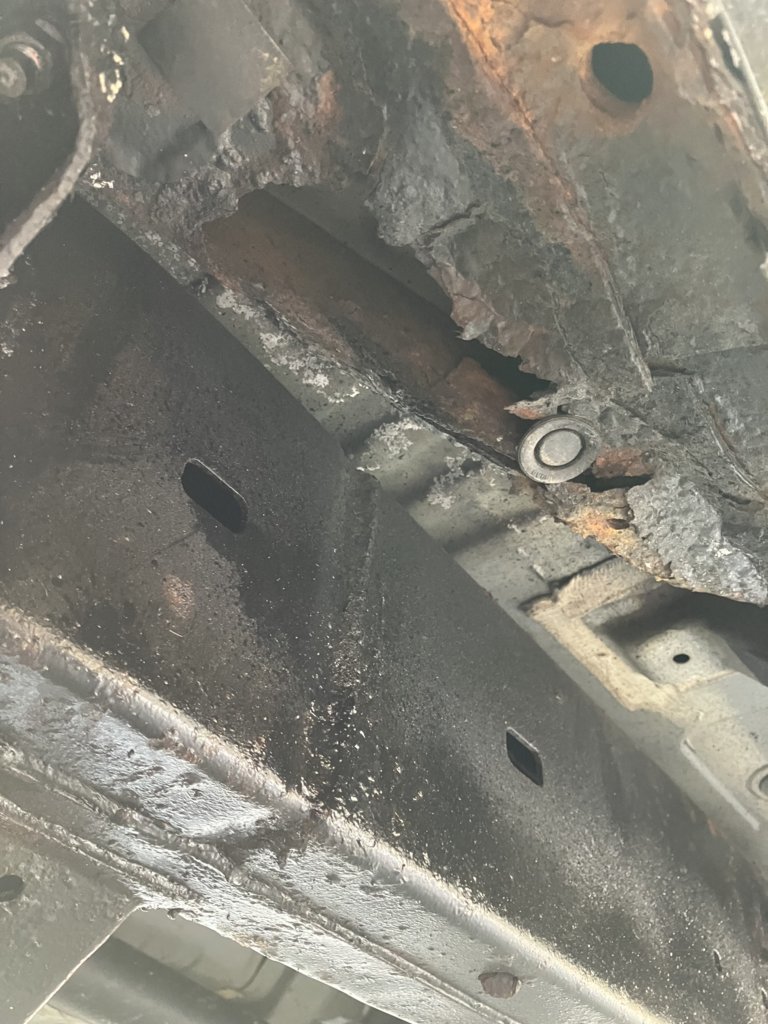

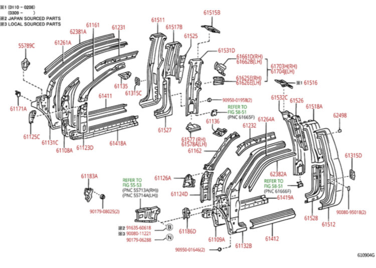

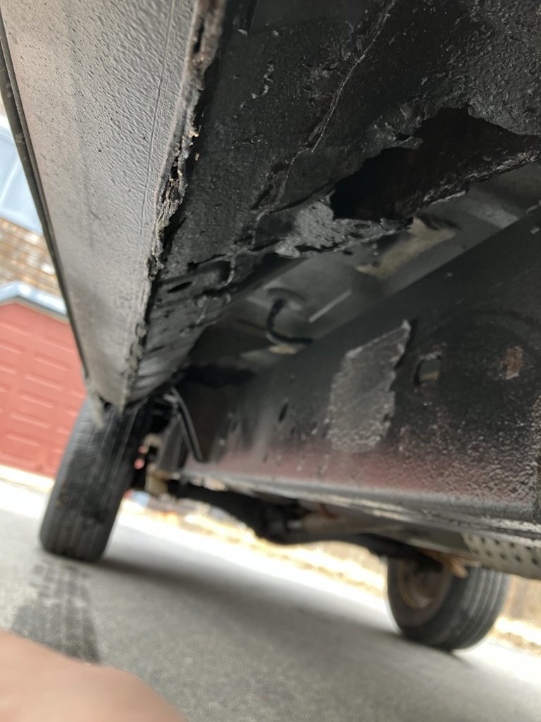

    Well, good news. The discontinued outer rockers on my truck are doing better than I remembered. It’s the inner rocker or “reinforcement rocker” that has rusted through (parts
    61418-0C030 and
    61419-0C030, I believe).
    My local dealer parts department sent my this fiche based on my VIN:
    The *actual* rocker panels, 61412 and 61411, are a bit delaminated along their lower edge, and probably badly pitted inside, but they are not perforated. I’m pretty confident they won’t need replacing.
    Here are the holes in the inner / reinforcement rockers.

    That frame looks pretty good in comparison. I’m surprised you or the prior owner didn’t do anything to protect the rocker panel as well. Hopefully your bed isn’t rusted through as well.
    Good to hear they have the part.
    FrenchToasty likes this.
