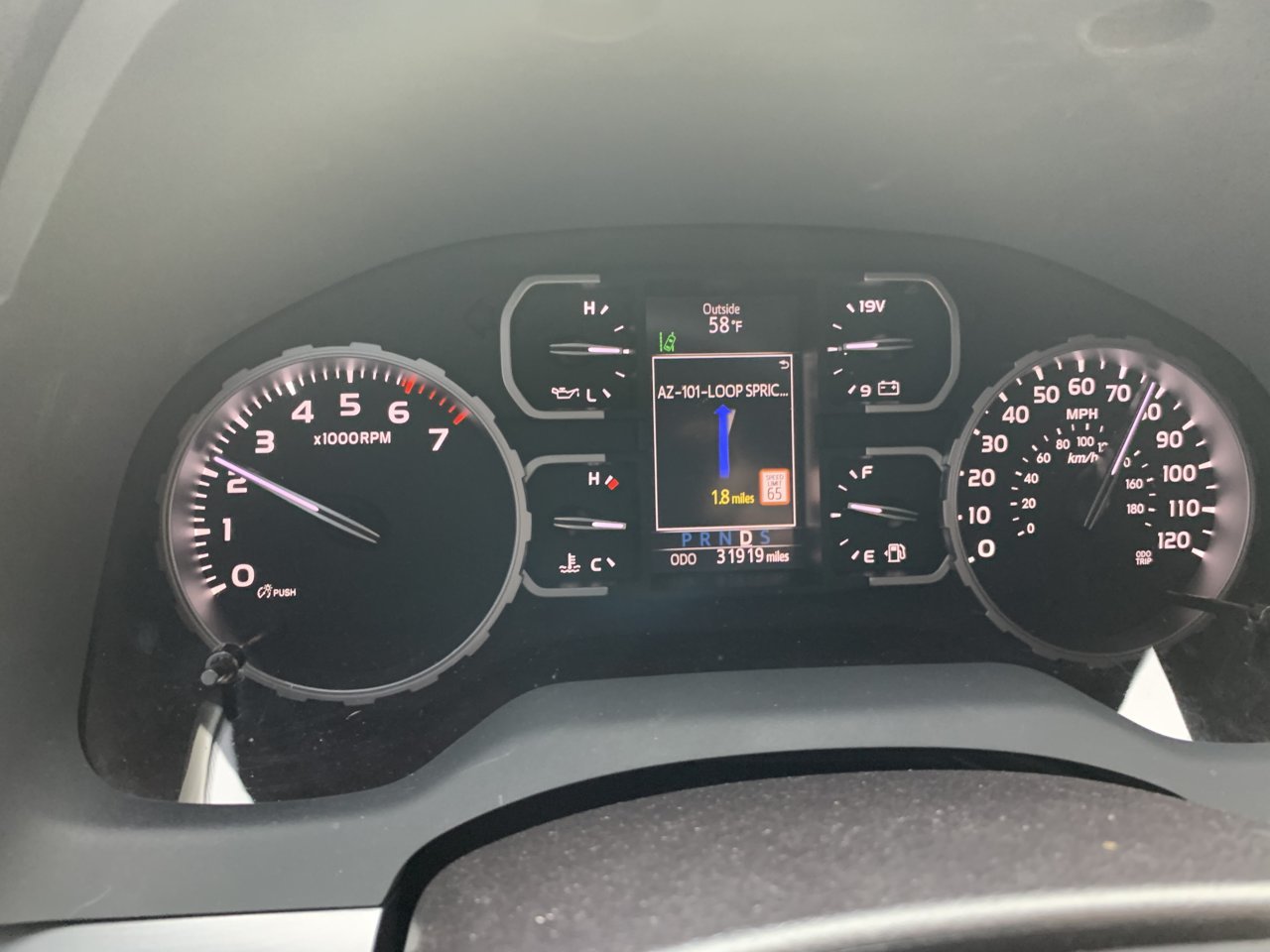

    Montrose, CO
    *** OV Tune Order #4481 *** ECU 0CN21 ***
    2018 Tundra Platinum with Icon Stage 9 w/3.0 and billet UCA, Harrop Elockers, 5.29 on 37’s
    yeppers and with all the additional weight from armor, tires, etc. it works
    The Speedo has been corrected so the actual speed and RPM are accurate

    Haha! This is just slightly faster than the posted speed limit right?

    I forgot to mention that I have my Speedo corrected and it is right on. The posted speed limit is 75, the GPS from 2018 is slightly off on when it starts and stops the speed change location

    I don't think the posted speed limit is 75 anywhere on the 101... but your secret is safe with us :fistbump:
