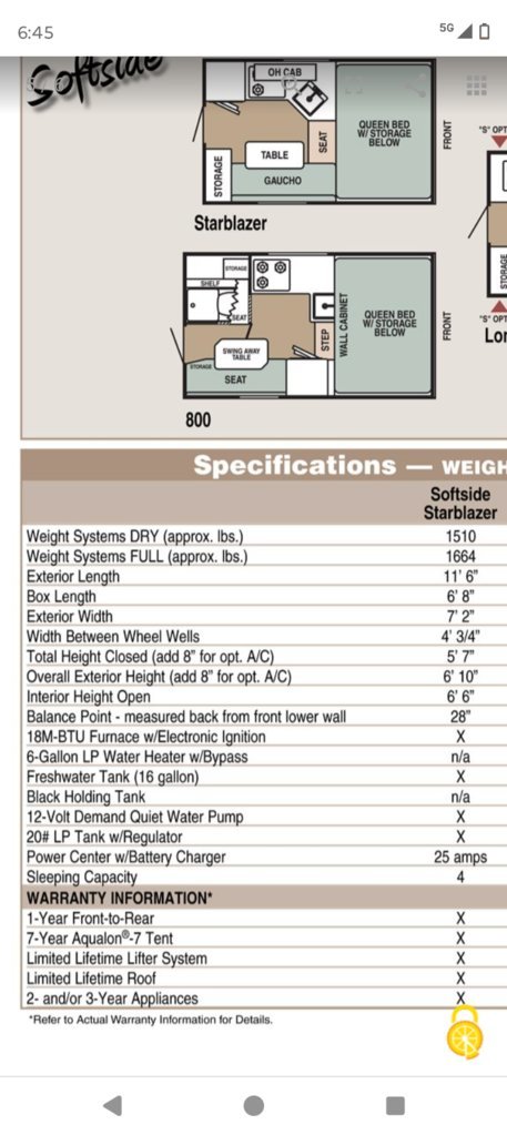

    Not sure what the payload is on the door jam for a regular cab but the payloads are garbage on Toyota trucks unfortunately (it’s only 1300 pounds on mine which includes my fatass) most slide in campers start around 1500 pounds although there’s some light ones like alucab which start around 900 pounds but even then that’s iffy for me

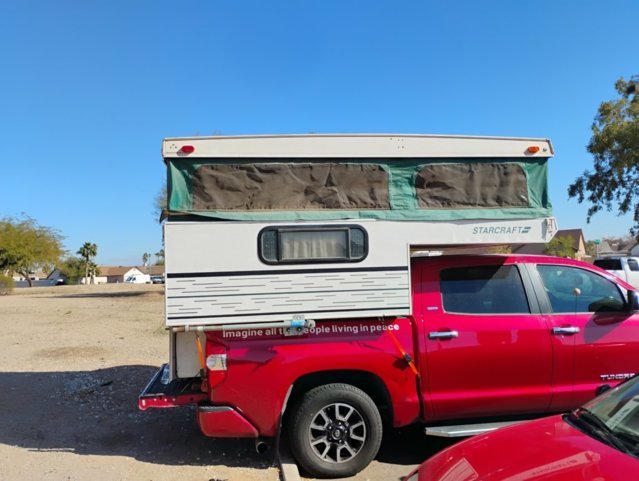

    It's not so bad.
