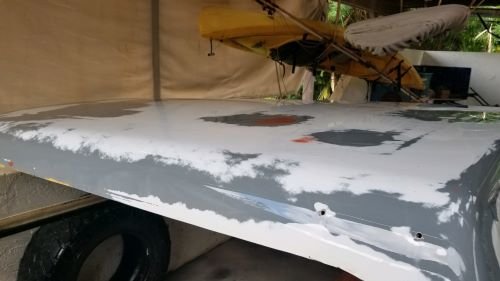

    Paint:
    After removing it from the truck, I put it in the paint stand and began inspecting. It had a few leaks, clear coat was peeling, and was dirty, but overall it was in good shape structurally.
    First primer coat:
    The clear coat was a PIA..I essentially had to take it down to the original primer, glaze and sand again. Then the epoxy primer nightmare. After going to the paint store and being shocked by the prices (used to paint cars and had been at least 15 years since I had been in that store) I didnt think twice about usingthe primer and catlyst I had sitting around from a job long time ago.
    Had them shake the primer at the store, and did not think about the catylst going bad. The primer went on ok, not great, but I was going to block it anyway. A few hours passed, tacky. A day passed, still tacky. I soon realized what happened and was thinking I would have to strip the entire thing down possibly chemically and start over. I decided to just let it sit and see if it would harden. Slowly it was getting better and better, and after a week it looked like I was out of the woods. Whew! I let it sit another week and was able to sand it. Got lucky. I reprimed it with some high build primer and continued.
    Second primer coat
    First Coat:
    Color sand and compound:

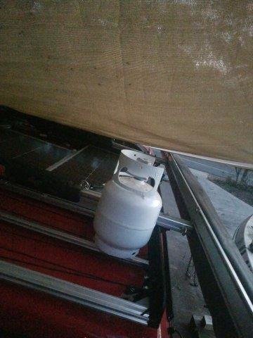

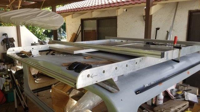

    Rack Build:
    So this may have been the most challenging part of the build. I was considering a rack from one of the offroad outfits, but in the spirit of keeping this build as inexpensive as possible, I decided to build my own. Shipping costs alone from the mainland add an entire dimension to costs here. As well, I could customize as I went along. It is built with all aluminum.
    Initial layout:
    Solar panel mockup
    Mount mockup:
    Side rail mockup and fab:
    Solar and accessories mockup:
    Paint and reassembly:
    The paint is actually high quality trim paint. Holding up really well so far.
    Pau with Rack. I have since taken off the Thule SUP carrier and added rack pads.
    It turned out super strong and light. Lots of room for further customization. I later added the propane tank mount and awning bracket.

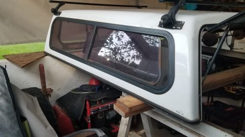

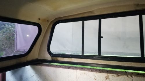

    Windows:
    Prior to the rack install, I rebuilt the windows with new seals, tint, paint and new screens, and added carpet to the inside:

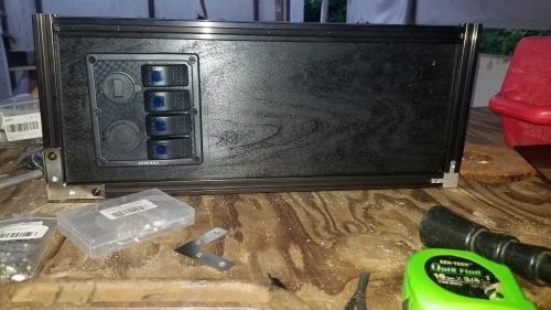

    Time to start the interior build. I wanted to go as light as possible and integrate a DIY topper lift. The lift is currently installed and works, however, I am modifying it and will include that portion of the build in a future thread.
    I selected 1/4" birch for the paneling and used 2020 extruded aluminum for the frames.
    Mocking up the actuators
    Frame mockup
    Panel mockup. I used doors and a drawer out of an old Vanagon stove cabinet that I had in my boat. It was termite ridden (not the parts I used), and other parts were used in other portions of the build as you will see. As stated earlier, I used as many recycled parts as possible.
    Drivers side
    Passenger side
    I also added some Molle panels to the sides.

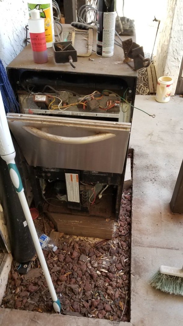

    The "Tool Kitchen":
    This was probably the most fun of all the projects on this build. I took the idea of a "Pull Kitchen" which was initially posted on the Tacoma forum and decided to build my own. https://pullkitchen.com/ The shipping to Hawaii make it cost prohibitive, thus my use of recycled parts. I think the price for those kitchens was on the order of 4 to 5K, then add in shipping...you get the picture.
    It has wheels so I can remove the entire unit, independent fuse panel powering the lights, water pump and usb ports, 4.5 gallon water tank, sink and stove, built in cutting boards and tables, spice racks, etc.
    It started with an $80 tool box off of Craigslist.
    I already had purchased some slides with the idea of a Fridge slide in the rear of the cab. I knew I had a stove and sink out of a Vanagon in my boat that was falling apart and not being used. Started with some measurements and it seemed like it might work:
    I had an old ice machine, and pirated parts from that, as well as a few parts from an old propane grill:
    Trial fit prior to removing bedliner:
    Building the slide frame:
    Fabbing the Fridge slide:
    Lighting:
    At Camp!
