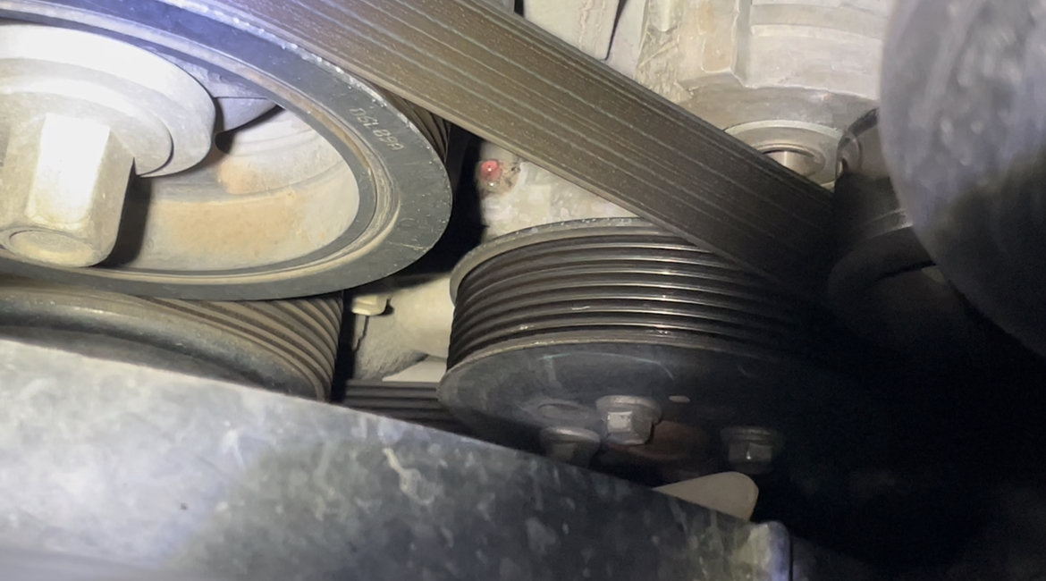

    Is this transmission fluid? Please god no. It’s at the front, so I have no clue what’s dripping. Just noticed.

    Drip there after removing skid plate. I think a watery drip? But sorta has a goop to it. Awesome stuff after blowing cash on Christmas gifts.

    You may have a water pump that isn't 100% sealed, or you may have a coolant leak in the valley. Neither of these problems is the end of the world, especially if you are willing to work on your own rig. You can pressure test the system to see how bad it is with the engine not running. Toyota has a document somewhere about what normal water pump leakage looks like, but I would err on the side of caution and just plan on replacing it if that's where the drips are coming from.

    I think this is what I remember seeing. You're not necessarily supposed to replace the pump for #3, but I sure would.
