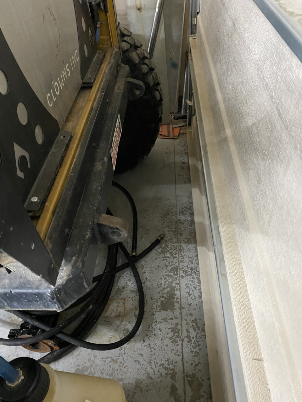

    I like where your mind is and considering safety is a top priority.
    We spend thousands on suspension, tires/wheels, drivetrains, etc. Recovery gear and proper use is a smart way to set up your off-road vehicle. I'm never in mud, so the vacuum that creates is not experienced. We do recover from rollovers and very off camber angles...and not in opportune situations.
    What can I say? All my recovery points are welded/built into my frame. I yank on them pretty hard at times and do not want anything "coming off" and smacking me upside the head. I have personally witnessed a shackle come loose under tension and cave in the complete bedside of a truck. I was impressed.
    If buying a quality mounting point makes you feel better....do it.
    I haven't heard of any recovery points failing on the Tundra, but there's always a first time for everything.
