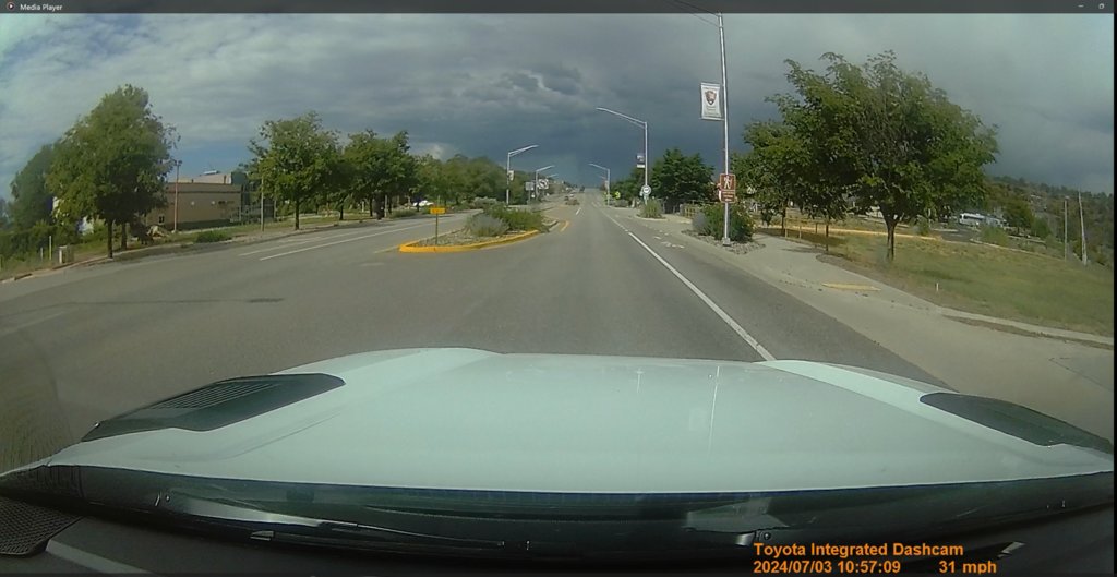

    Great idea! The dashcam is better for long distance though I think. They **should** record all though, for self defense purposes or whatever. Here's a print screen of the OEM dashcam video:
    That Lat/Long is below the date/time/speed stamp. The dashcam records in MP4 to a microSD card.

    The video on the dashcam is not encrypted. It's a straight MP4, you can take out the microSD card and upload it to your PC.
