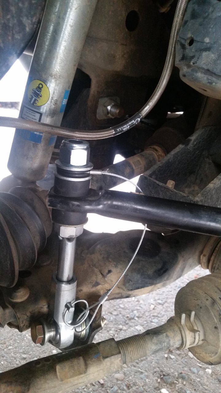

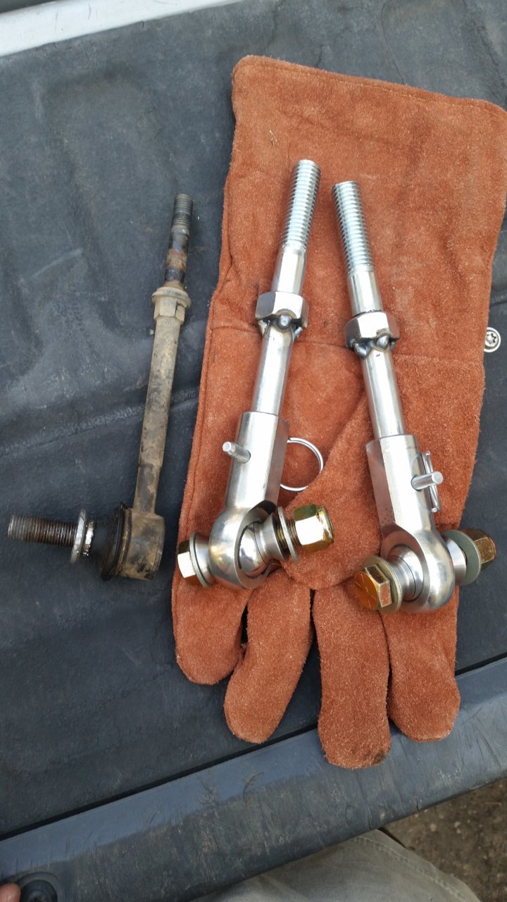

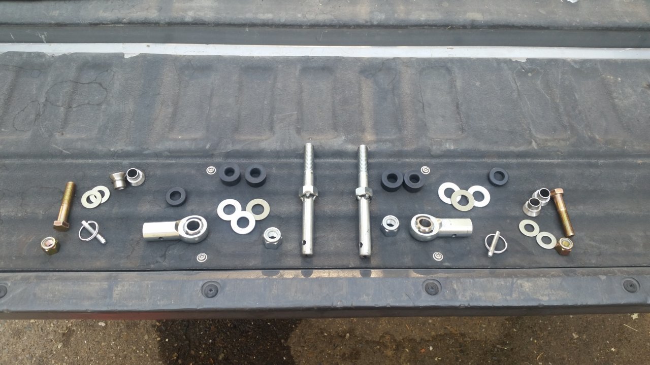

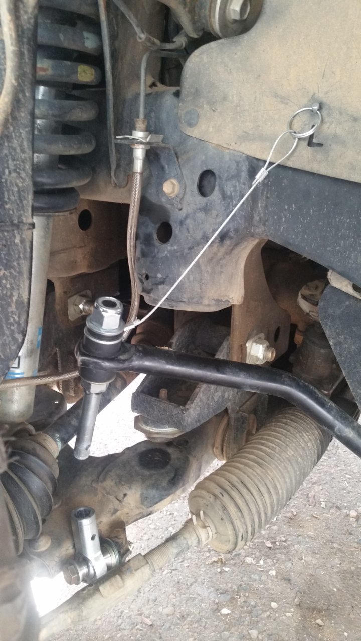

    My 6 inch rcd lift comes with sway bar relocation brackets. You might be able to connect rcd to see if you can just buy the 2 brackets. http://racecardynamics.com
    You can also just make your own end links to what ever langth you need. I made my own links with quick disconnect for under 100$. After I had all the parts it only took like 3hr to make and install.

    I was looking for someone that has done a quick disconnect for the sway bars. Care to share pics?

    They're probably not the most professional thing in the world but they work great.
