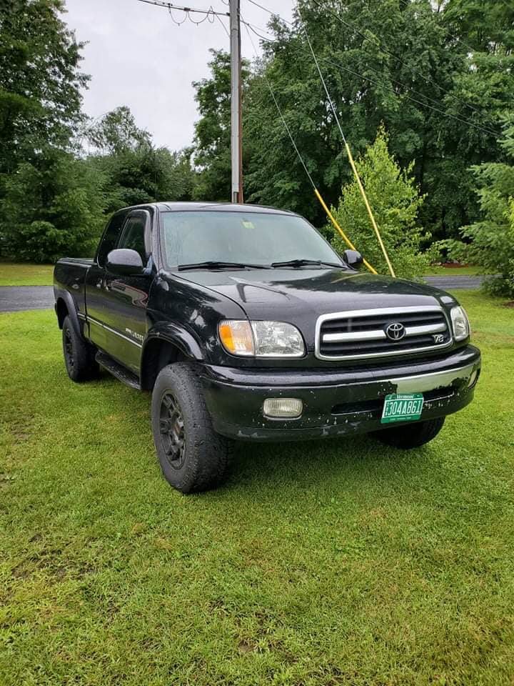

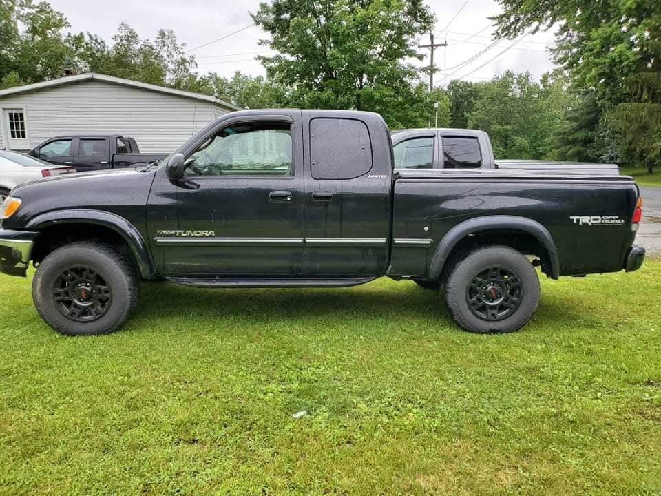

    Not perfect, but cool truck anyway. Already changed the oil and battery. LBS's and ITRs were loose upon inspection. Squeaky too! I recently picked it up with 149K. Just got my OEM LBJs and some Sankei 555 ITRs, said screw it and ordered the matching OEM UBJs and Sankei 555 OTREs. Didn't notice any play in the control arm bushings. How do those hold up?
    I already cleaned up the front bumper and am about to prep to make it black again.

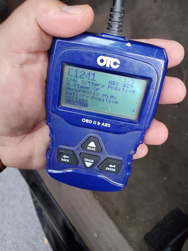

    8. Chase the C1241 code down....grrrrr!

    Good find. How does the undercarriage look? Lower control arm bushings last a long time but can wear from lifting without relieving the tension. Factory ones are kind of spring loaded.

    Welcome from SoCal. Cool truck. I'd check in with the first gen people, but I think they recommend a timing belt at that mileage if the prev. owner didn't do it.

    May get lucky enough to just clear those abs codes. Those could have come from a dead battery.
