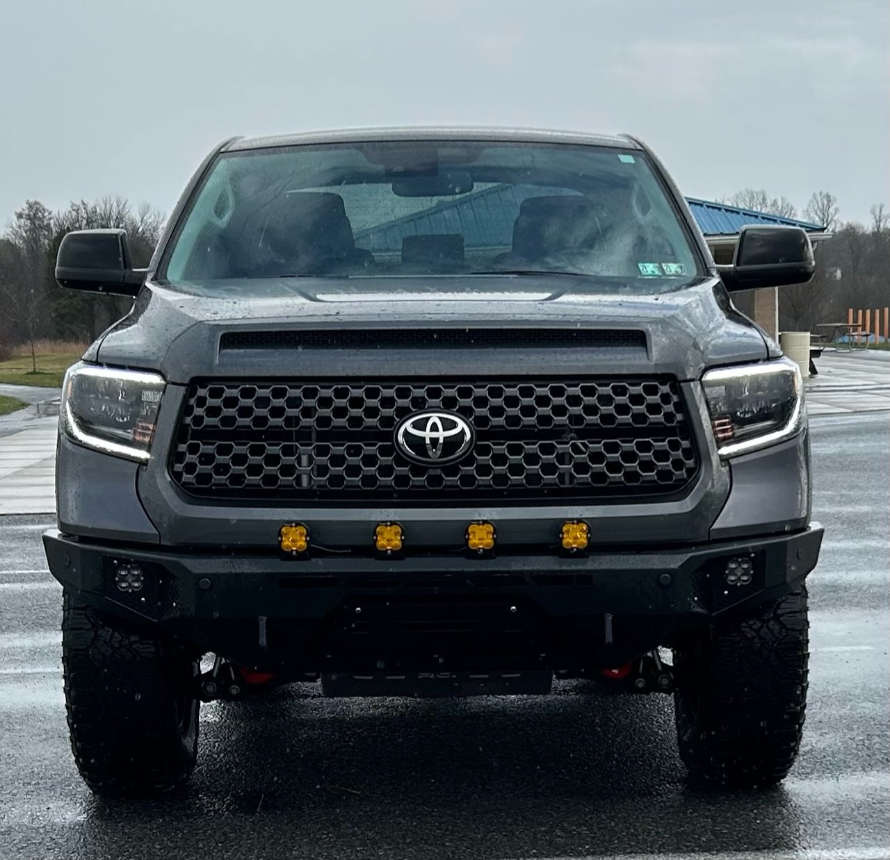

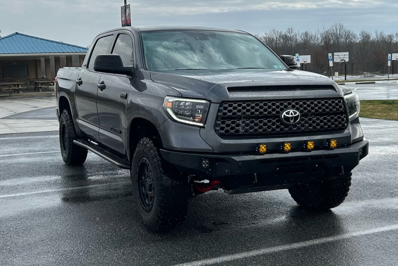

    Huge thanks to the forum. It’s helped a lot leading up to the install and all the mods prior ! Everything went together great. Aligned great and everything clears just fine.
    Recently installed
    -JBA UCA’s
    -Bilstein 6112 @ 2.5” lift
    -Icon RXT Leaf Packs at 1.75” lift
    -285/75R18 Duratracs//AR201 +40 offset wheel
    Other mods
    -RCI Skids
    -RCI sliders
    -CBI front bumper
    -Baja Designs fogs
    -Auxbeam amber spots
    -Trigger 4 controller
