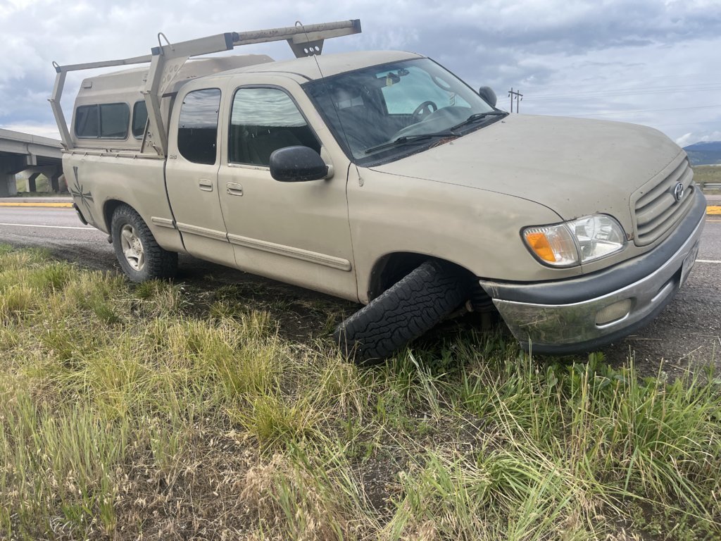

    Stock
    Hey all,

    KNABORES Sarcasm incoming

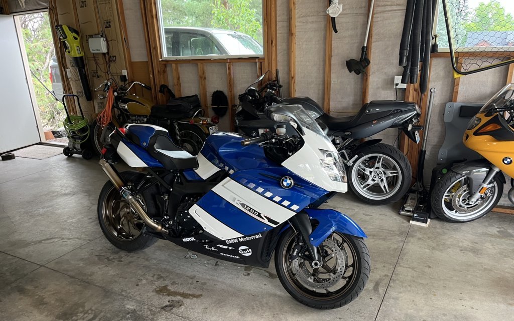

    Im familiar with the whole recall process as I ride BMW motorcycles, and whether the part on my bikes actually failed or not, the dealer is obligated to replace (said) part at manufacturer expense. Shouldn’t Toyota be obliged to replace my lower ball joints? Even if they haven’t yet failed?

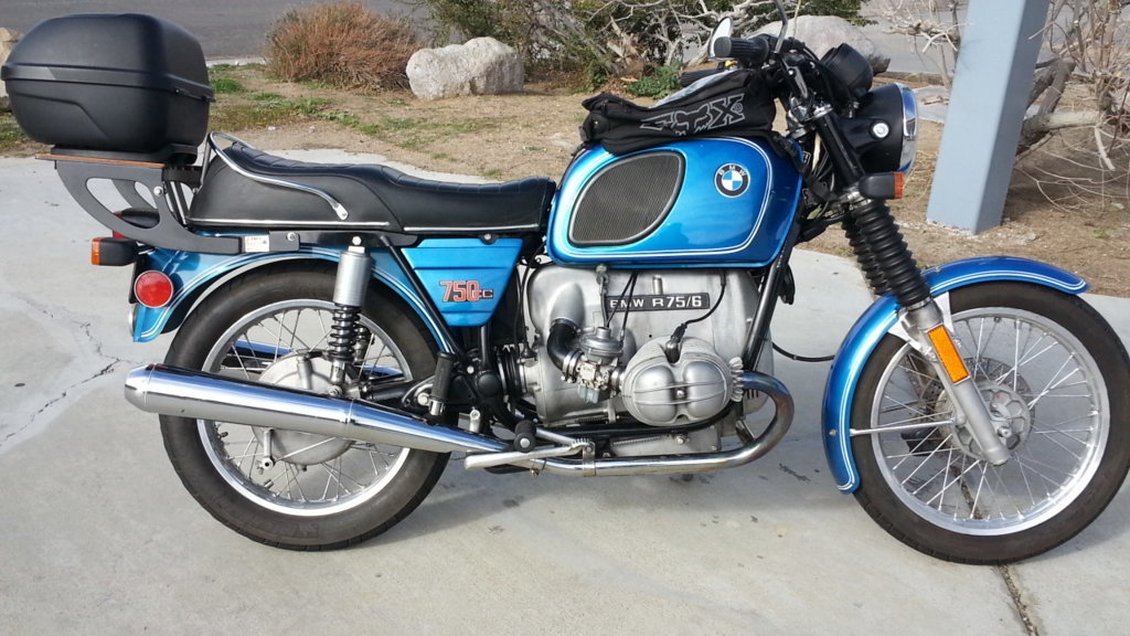

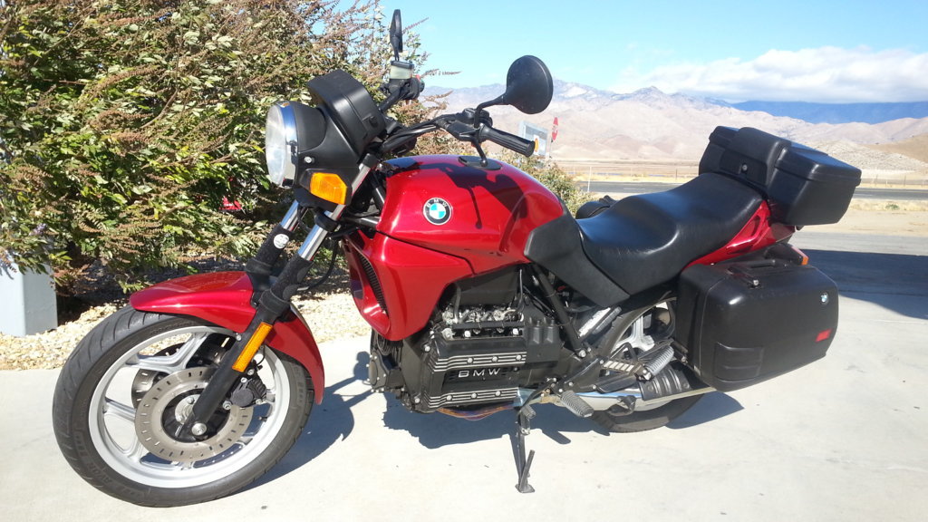

    Cool on the beemers, I've been riding them for 30 plus years but mostly airheads and k75's. Only one with a paralever drive, a 92 Mystic. I now am riding a 2010 V7 Moto Guzzi Pretty cool so far. Simple 2 valve motor, an airhead BMW should make. Sorry for the hijack. My Mystic below.
    My k75
    My last airhead
    Cause we all like pics. And I just dig motorcycles.;)

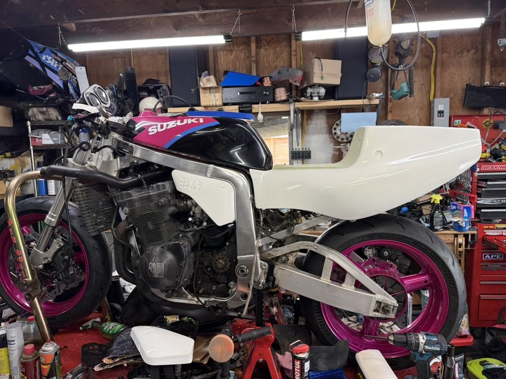

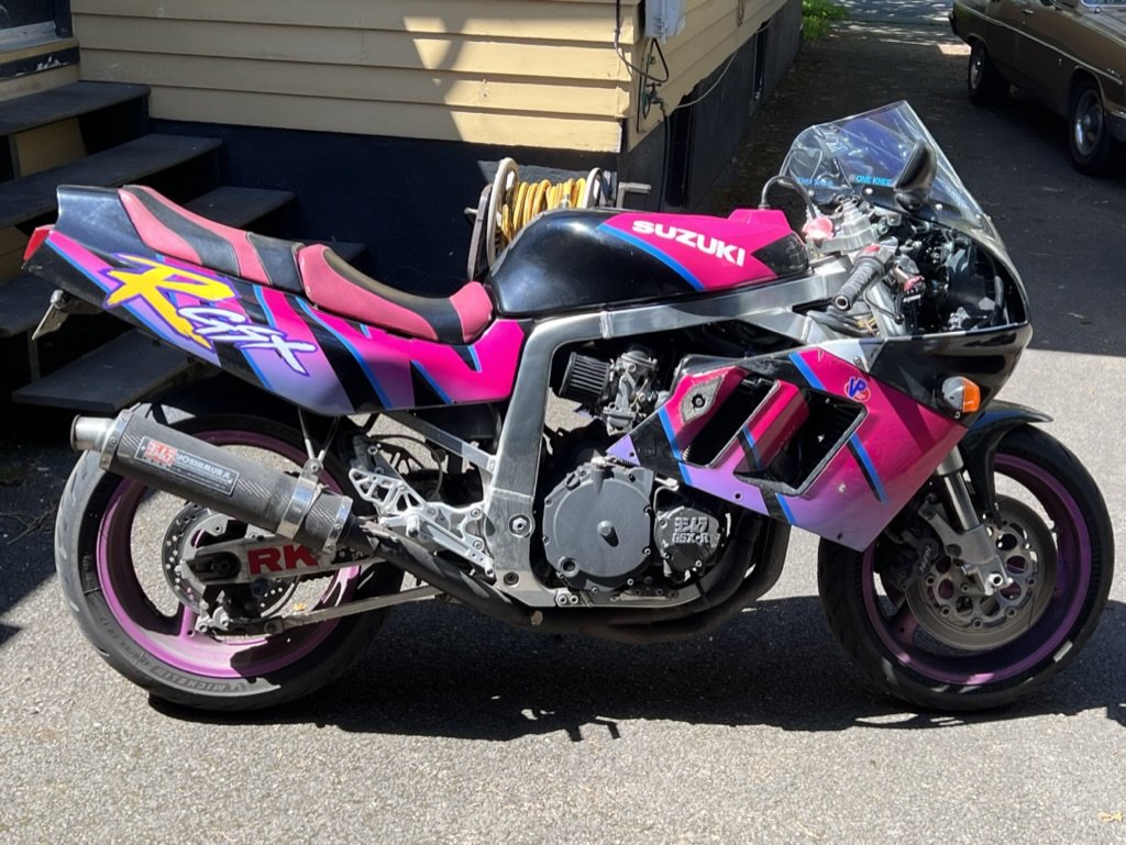

    I am primarily an oil cooled GSXR guy and can't leave bikes stock. Got a shelf of spare engines in the garage, couple extra frames in the basement. I've been known to drive 3 hours to pick up a bike that I'll strip in the same day just to have extra spare parts...it's a hobby not a problem.
    89 7/11(750 with an 1100 shoved in it.)
    92 750 with the best factory pain job ever! Currently getting a full frame up rebuild, newer forks, lighter wheels, Ohlins shock, and a 1200cc engine with hot cams and a high compression head.
    And this is how it currently sits, I need to get off my ass and start working on it again before winter gets here.
