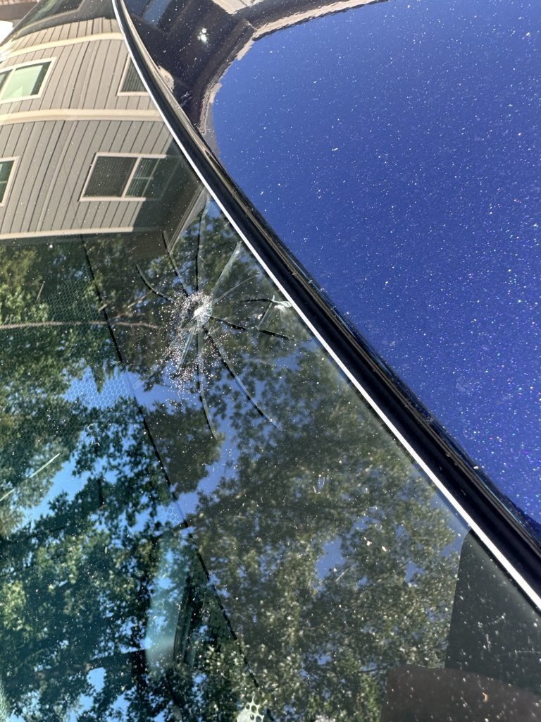

    Just had a rock hit my windshield. Put a nice ding and a crack. I assume the whole windshield will need to be replaced and I’m taking it in tomorrow.
    What happens to the sensors? Do I need to take it to the dealer and have that fixed too?
    Anyone have an experience with this?
