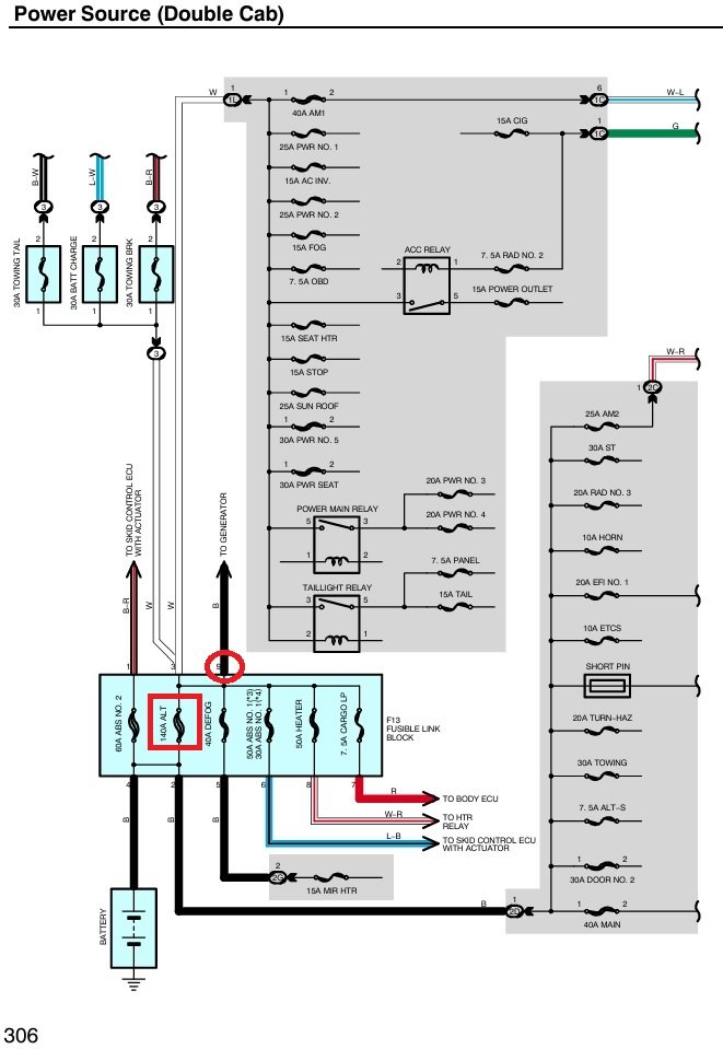

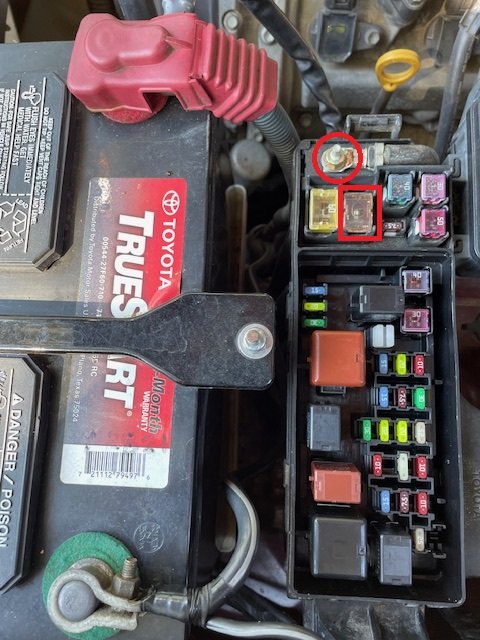

    Having just re-read thru your initial thread.... I picked up this 2004 for $550 | Toyota Tundra Forum (tundras.com) and the other 3 related threads, have a few questions in case I missed something.
    This is the same 2004 DC you bought for $500 ?
    You or someone re-built the engine or you put another re-built engine in ?
    The thread started on July 23 with the pic of a main harness 82121-0C021, did you put another harness in after the fire ?
    Hello everyone, been a long time since I have been here | Toyota Tundra Forum (tundras.com)
    I would start at the main fuse box and check for 12vdc at the red circle and visually check the 140A ALT fuse(red square). If the 140A ALT is blown, steps for removal can be shared(can't pull straight out). Those points are the first place the battery voltage goes to before branching off to other places.
