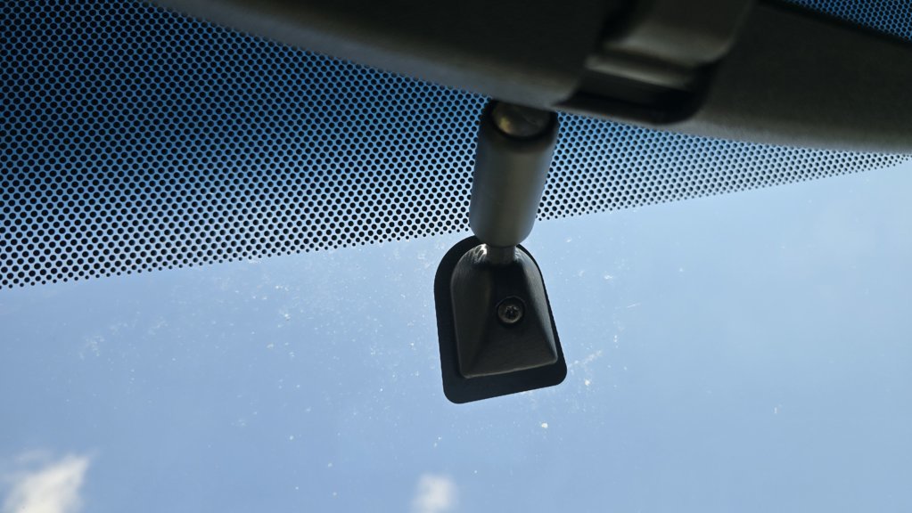

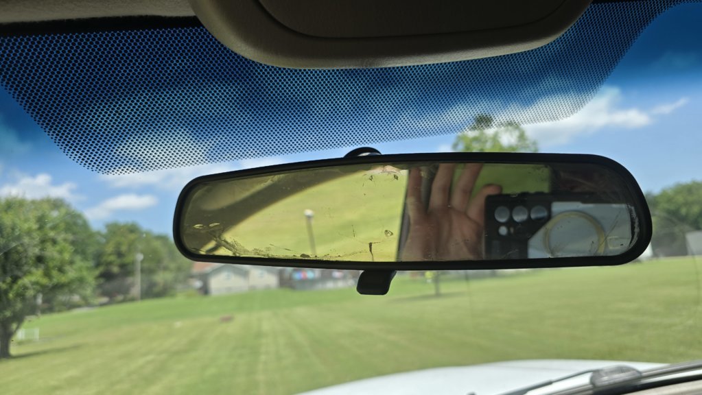

    My rearview mirror seems to be delaminating or whatever you'd call that.....is that held on by just this one screw? If so I'll try and order an OEM replacement this week.

    I thought they were glued directly to the glass, maybe a mount is glued on and the mirror is screwed to the mount. Take the screw out and remove all doubt.

    Mount is glued. Mirror slides on to the mount and is held in place with just that 1 screw.

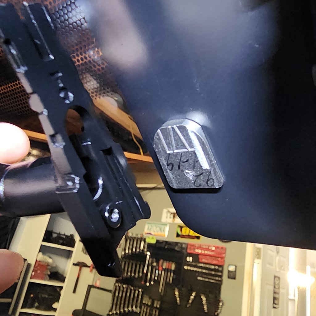

    It's a set screw. Should look something like this once removed..
    That's off my 2.5gen but I'd imagine 1st gen is similar.

    Great......thanks.
    So I can get a new mirror and screw it right on?
    Edit: replacement OEM mirror ordered! :)

    This is the warning I'm going to give you. Mine was doing the same btw.
    BE CAREFUL when removing. On our older vehicles, it's probably never been removed. You can VERY EASILY break/crack your glass. I recommend to fully remove the set screw. Grab ear the base and GENTLY try sliding the mirror upward. You may need to GENTLY wiggle back and forth as you lift up GENTLY.
    Why do I keep saying GENTLY in caps? Because the metal mirror base and the mirror keystone on your window have likely bonded together, and that bond can, often times, be stronger than the bond the adhesive has on your glass. The end result can be you yanking a scallop of your windshield out, or if you start tapping on the base, you can easily crack your windshield.
    Sometimes you get lucky, you pop off the screw, grab the base and wriggle it a bit, then it slides right up. Just go slowly. Be GENTLE. And remember it goes upward.
    Once the mirror is out, that's a pretty standard keystone, unlike some of the earlier Tundras that used the Donnelly mounts. Really any mirror that supports a standard keystone will slide right on there.
