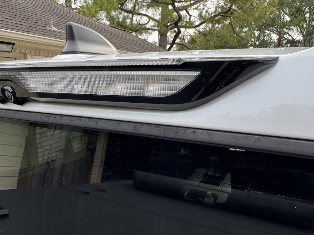

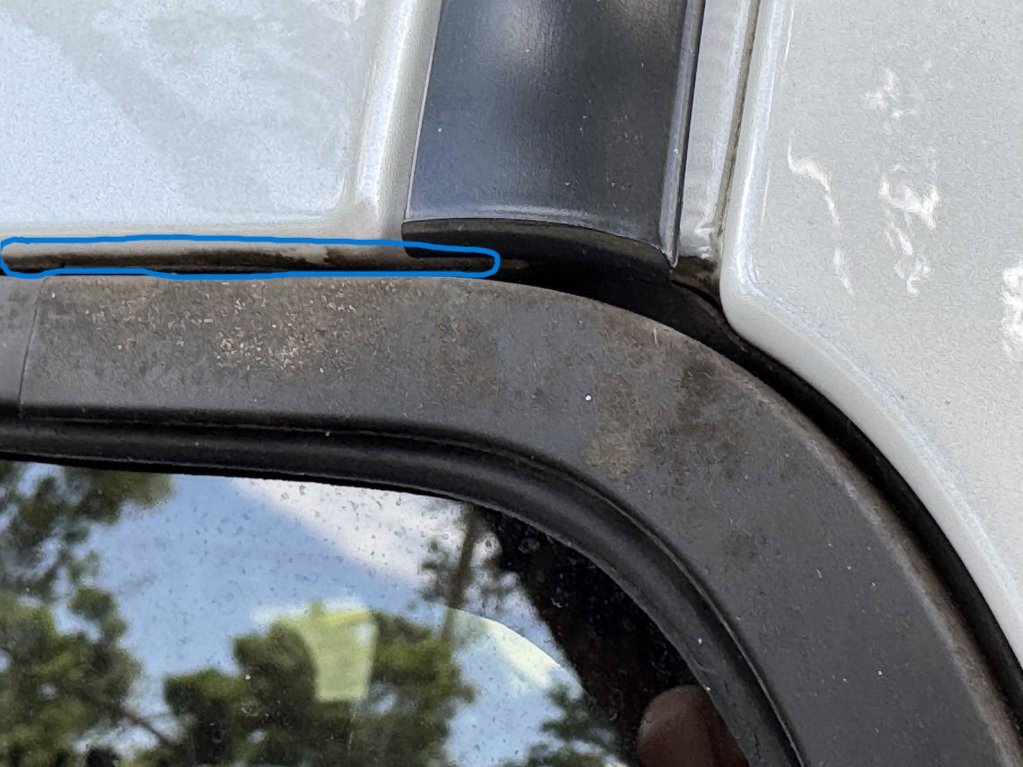

    2024 Tundra Hybrid Limited is showing some corrosion on the rear window door channel run. I am not sure if this part is the window panel run, window seal or weather stripping as the parts diagrams online diagrams are all over the place. This truck only has 16,000 miles on it and is not old, so any ideas why this corrosion is showing up? I tried rubbing it off with some different corrosion remover products, but they made minimal improvement. Appears as iff it's rapid oxidation of the finish or similar to rust. Any ideas? Thanks for any advice.

    Trees, I see plenty in your reflection. If you frequently park under trees and don't specifically wipe those areas when you wash it, it'll build up. To me, it doesn't look like corrosion, but mold from trees.

    I'll look closer at this suggestion, although I do not park under trees regularly (very rarely) and this trim is the only area on the entire truck corroding like this. The rest of the trims and body are all in good condition.

    I have a 2024 and mine has the exact same issue. My truck is outside most of the time but the closest tree is 40 feet away. I just bleached the crap out of it and used meguires ultimate black to restore it back to somewhat normal

    That’s interesting..if I were to guess (and I am) I would say it wasnt treated/sealed properly on build. Should be covered under warranty?

    If this in fact corrosion, it's covered. Return to dealer.

    I cleaned and inspected best I could, and the black finish is certainly wearing down allowing the oxidation. I'm not sure what what is causing it. I feel confident it could be taped off, sanded and recoated/painted carefully, but it would be one of those tedious, take your time, PITA jobs. I should be coming up soon on the dealership schedule for the squeaking front breaks TSB and will ask the dealer when I go in for that.

    Finished up the brake squeal TSB at the dealership and I asked them to look at the window frame corrosion. Seems this is not overly common but does occur on other third gen tundras. We looked at some others on the lot doing the same thing. So no answer as to a possible warranty fix yet, or possibility of a TSB. They said its still functioning, and replacing the part would be quite significant. Best bet is to contact Toyota corporate and start there with a request for a resolution. I'm going to write Toyota, and hope others do as well.
