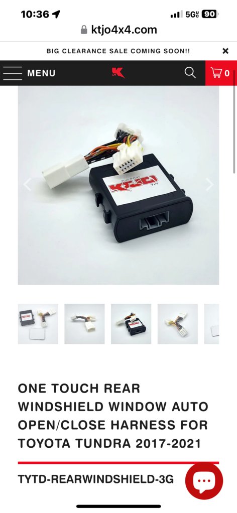

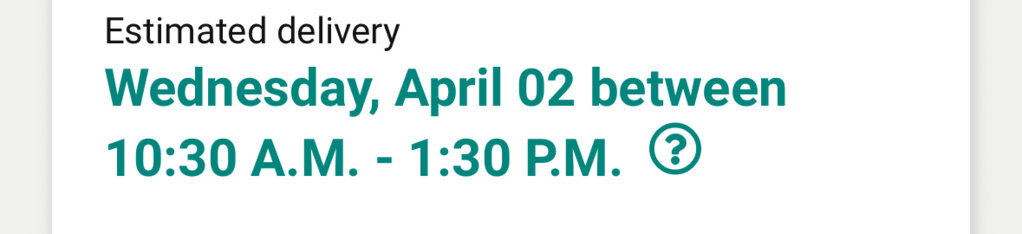

    This is where I got my front window controls and I just saw this
    Plug & play

    Plug and play is nice. I do not see any instructions on their site. Any idea exactly where this goes?

    Alright, pulled the trigger on KTJO based on ease of install, no splicing, and no removing rear seats / subs to access that rear panel for autoloc. I’m OK with a $40 loss if this goes south like some of those posts. Will report back when done.

    OP, I’ve had the KTJO rear window auto unit for about two years now. Yes, I took a chance with a blacklisted seller, but it has worked flawlessly. Easy install, no regrets. :thumbsup:

    Are you still able to roll the window down partially? Or is it one touch down and one touch up only?
  28. Mar 28, 2025 at 7:10 PM
    #28
    Cthulhu
    Cthulhu The White and Black Goat of the Woods
    Jul 21, 2018
    #17251
    1,380
    John
    2018 Tundra Limited CM Premium Package
    Both, hold it down for more than a second, and it switches to manual. Small learning curve.
