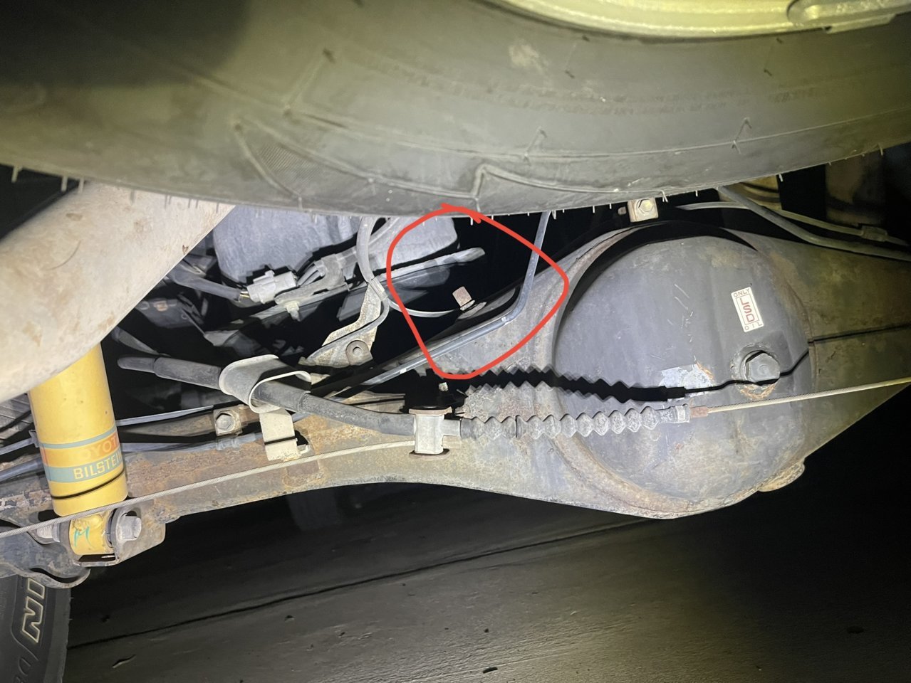

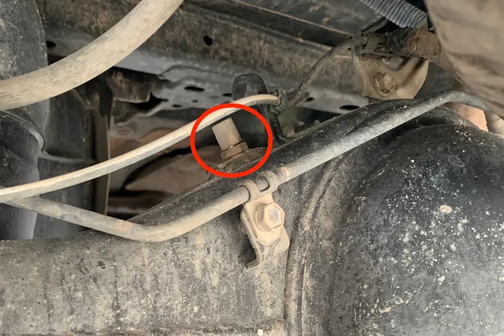

    How do I unclog the the diff??​
  15. Sep 6, 2023 at 7:16 PM
    Mr.bee
    Mr.bee King Turdra
    Jun 4, 2022
    #79178
    6,424
    SATX
    '02 AC TRD
    Suck on it. But give it the wiggle test, too.
    DJenerated likes this.
  16. Sep 6, 2023 at 7:18 PM
    Brockp3004!!!
    Brockp3004!!! [OP] New Member
    Sep 6, 2023
    #103495
    21
    Brock
    02 Toyota Tundra rear wheel issues
    Where is it located??
  17. Sep 6, 2023 at 7:21 PM
    Mr.bee
    Mr.bee King Turdra
    Jun 4, 2022
    #79178
    6,424
    SATX
    '02 AC TRD
    On top of the axle.
    from under the rear of the truck:
    remove it, clean it, replace it. Check that it opens.
    not replace it like buying a new one...i meant put it back in.

    And it should be a one-way valve, lets air out at a specific pressure, doesn't let it back in.
    Spin the top, try to push it in/out, pop it off to blow and attempt inhaling through it, you should only get resistance one way. Or just replace the f'n thing it's like $10, part number for my 2006 is 90930A3001 and it may be the same for yours (not sure).
