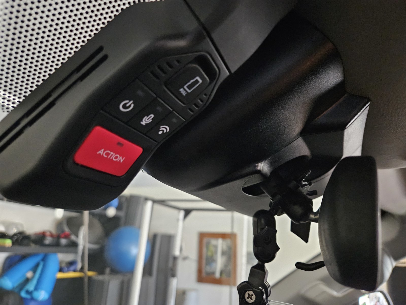

    I don't see a way to access the harness. There is nothing on the back of the mirror.

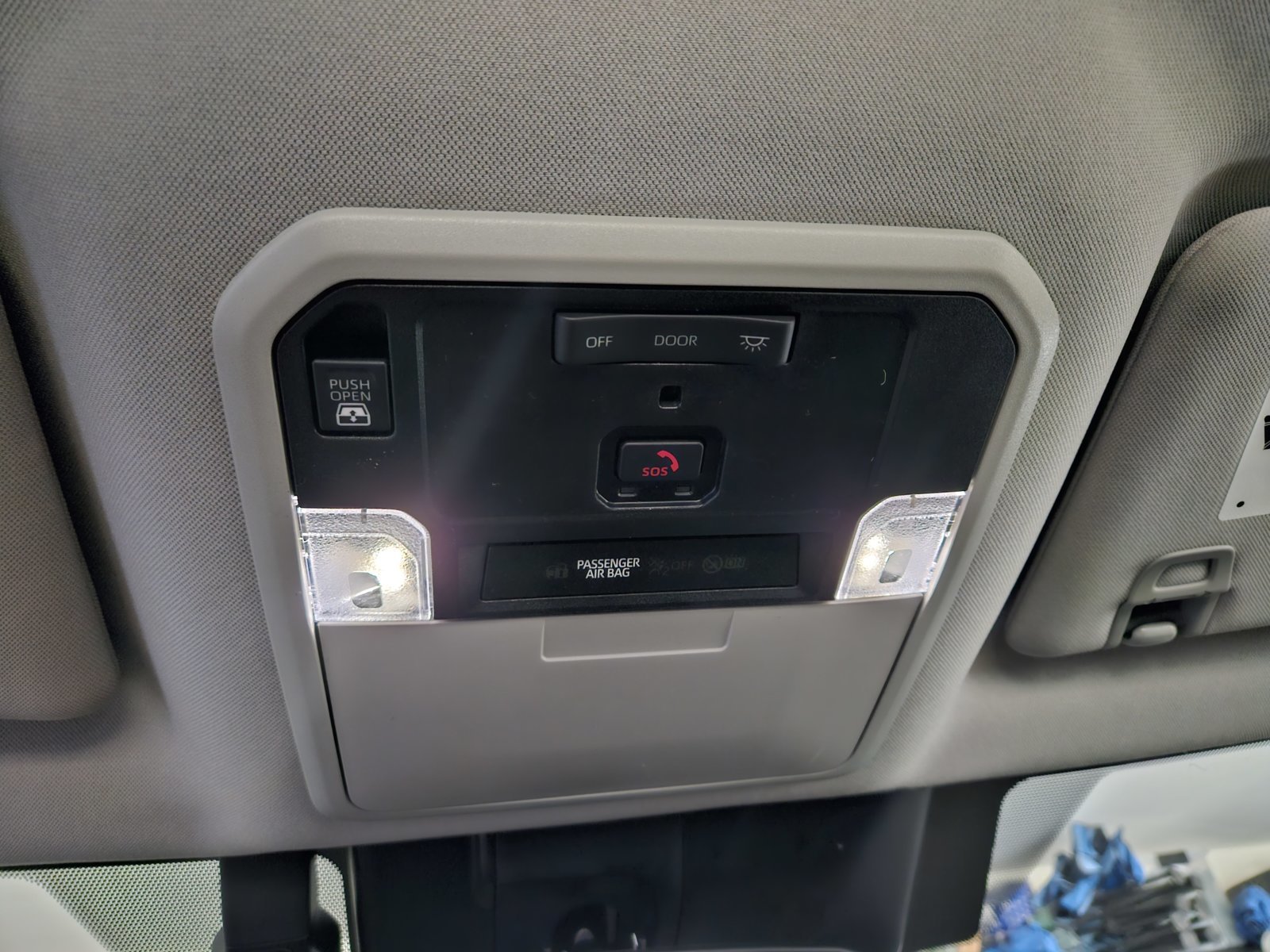

    You will find a power cable once you take the overhead console down. And with a Dongar adapter you'll have a USB to plug into.
