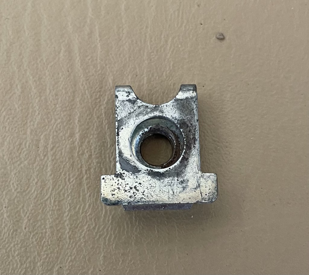

    Hello everyone. I have a question about the rear taillight on an '06 Tundra. I am missing one of the bolts that secures the taillight to the truck. I found that that little metal screw clip that goes on the taillight housing is missing so now the screw can't bite to secure the light. I searched for the part on Toyota parts website but found nothing, so I spoke with Toyota parts and was told Toyota doesn't sell that little metal u style nut and I would have to buy the entire light but that ain't happening. Home Depot sells the "U Speed Nut (see link below for photo). Does anyone know the size of that taillight bolt or where I could find that specific metal screw clip? I'd appreciate any help.
    https://www.homedepot.com/p/10-24-in-Plain-Steel-Type-U-Speed-Nut-800068/204276062
    Thanks...Al

    Take another bolt to HD and use their guide to tell you the thread size.

    It's gonna be a regular M6 bolt that fits it, but you'll have to find the right style of clip that fits the tail light side. Can you take the other one that you do have out and find something similar?

    Thanks for the sizing. I had planned to do that if no one here knew where to get the exact clip for the light.

    It looks like the bolt is used to hold a variety of Toyota taillights to the vehicle. Since the clip isn't available from Toyota individually, I'd take a trip to your local junkyard and check for a clip on any Toyota car/truck/suv taillight. I bet you find a matching bolt and clip for your Tundra. Plus, who doesn't like to spend a couple of hours wandering around a salvage yard???

    I went to Harbor Freight and bought a various pack of U clips since they were cheap. The #10 is the best fit. I may go to the junk yard one day to see what little crap I can find and use since I've not been to one in many years.
