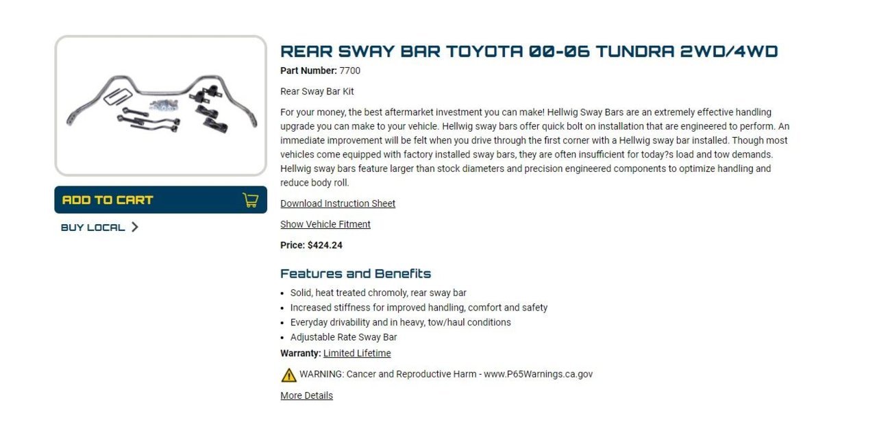

    Rear sway bar application applies to any generation.
    It reduces body roll on turns and cornering.
    It isn't rocket science..
    Drilling holes in the frame?
    WTF..?
    I installed a Hellwig rear sway bar on my 2005.
    No drilling required..
    I have an OEM TRD RSB on my 2014, same results.
    The rear sway bar will reduce body roll on cornering and highway ramps.
    Nothing more, nothing less.
    I'd sell that drilling required shit and buy a Hellwig before I started drilling holes in my frame...YMMV
    Hellwig Products Search - Hellwig Products
