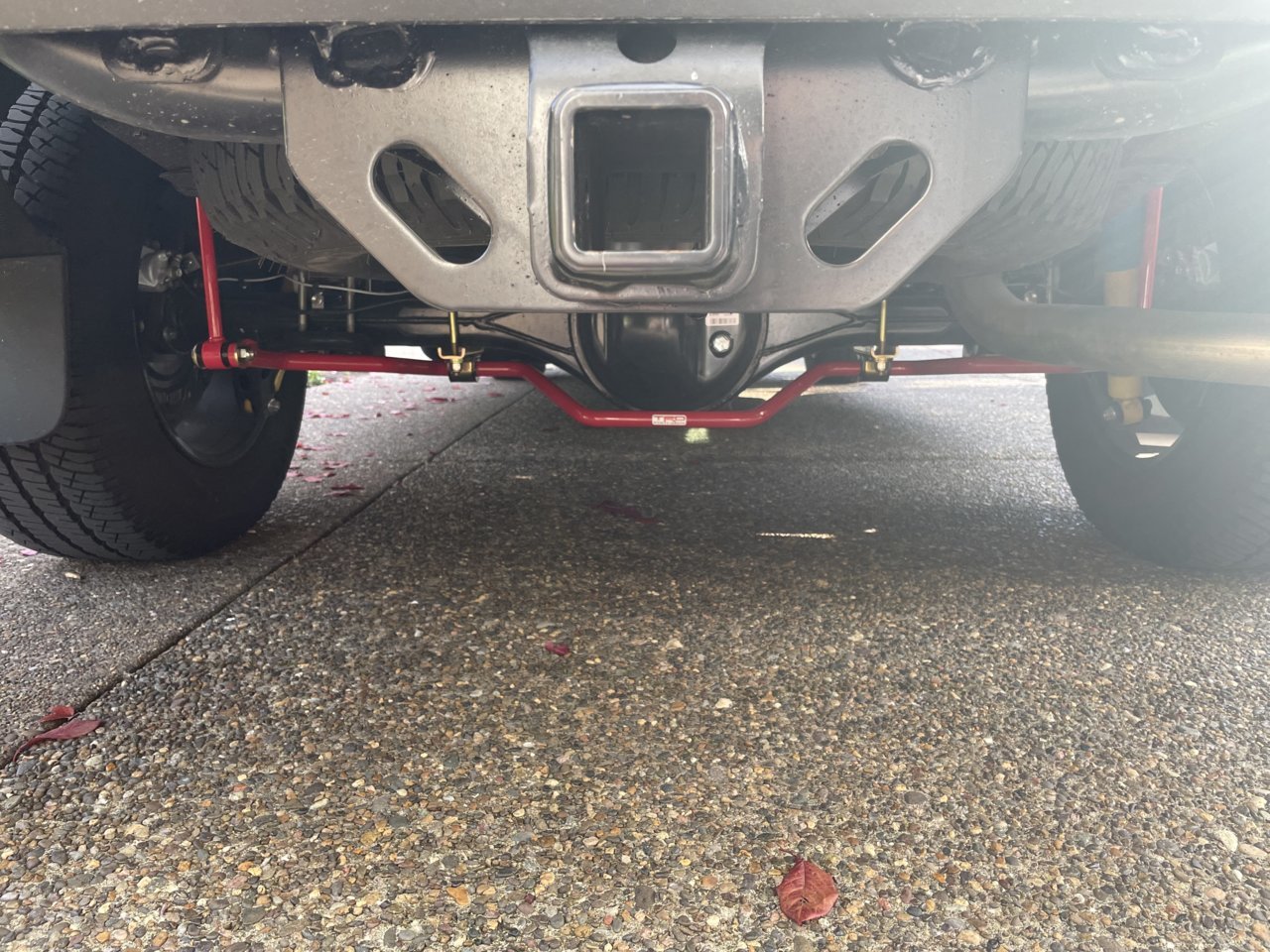

    Installing the trd rear sway bar was easier than building with lego. Took me less than 40 minutes with no helper-- no stool needed to hold it up, either. Just a pair of Knipex pliers, torque wrench along with the 19mm and 22mm sockets, and plenty of anti-seize.
    The bolts going into the chassis didn’t fight me at all— although tightening those to spec felt much harder than it should have.
    We’ve all read it before- don’t hesitate to get the rear sway bar. I noticed the improvement when I rolled out of my driveway and immediately had a grin on my face. Toyota should send these installed out of the factory for sure.

    I noticed it the first time I hit an extra ramp off the highway a little spirited.

    Definitely a must do mod... Noticed on/off ramp takes, plus it looks killer.. Big fan!!

    Here is what I ordered from Sparks for my 2013. I just got the truck a couple months ago. Only 107k miles. But not knowing the history I ordered all new parts for the install. Definitely wanted new bushings so the bar will be as secure as possible to get the most benefit. Ordered new bolts after reading all the posts about rusted bolts. They are 8 years old so figured I would go with new. New brackets were overkill but figured I might as well get them too while I was at it.
    New bar is so much heavier than stock.
    Enter code "tundraforum" or "tundra forum" to get 5% off. Not sure which one. I learned about the code after I placed this order.
    Front:
    FR-SWAY TRD Sport Front Sway Bar $186.00
    48815-0C050 Suspension Stabilizer Bar Bushing (Front) $21.23 2 each
    48824-0C010 Suspension Stabilizer Bar Bracket (Left, Right, Front) $26.42 2 each
    90119-A0192 Stabilizer Bar Screw $1.82 4 each
    Rear: On back order
    ptr1134070 TRD Rear Sway Bar $209.00
    When the rear bar is delivered I will update with some pics.
    A lot of good videos on how to install.
    Tips from the videos:
    Going to get some anti-seize to put on the bolts. Best 3 anti-seize from a video test were Loctite Cooper, Permatex Aluminum and Nickel-Graf Anti-Seize.
    Should be enough grease in the rear kit to do the front bushings too. If not your will need to get grease for them.
    Use a torque wrench to install the bolts.
    Need 17mm and a 19mm socket.
    Put the end links on completely while the bar is not on the truck. You can not reach the nut to tighten it when it is on the truck. A part of the truck blocks where you would put your socket or wrench to hold as you torque the bolt.
    Can not find install directions for the front sway bar. If someone can find them please post them. I attached the directions for the rear sway bar.
    I did find these torque amounts for the front sway bar.
    If they are not right please let me know and I will edit this out.
    The torque values will be the same as stock.
    Stabilizer bar-to-link nut:...........................111 ft-lbs

    So, finally got the chance to install it this morning. I am slow and read instructions as I went through. Took less than an hour to complete. Took it out and first impressions are it is as advertised! Noticed immediately pulling out of my driveway and in local traffic circles there wasn't the feeling that I was going to roll over into the passenger seat any longer. Well worth it and thanks to all that recommended it.

    I thought the reviews we’re overblown at first. That thought lasted until 5 minutes after I installed it

    I’ve noticed a difference since installing mine. Presently surprised. 288746DC-F2B5-4244-A2F7-5AEA89D9E8A2.jpg

    Got mine installed.

    I have to say, the sway bar does improve road manners quite a bit. It looks cool too.
