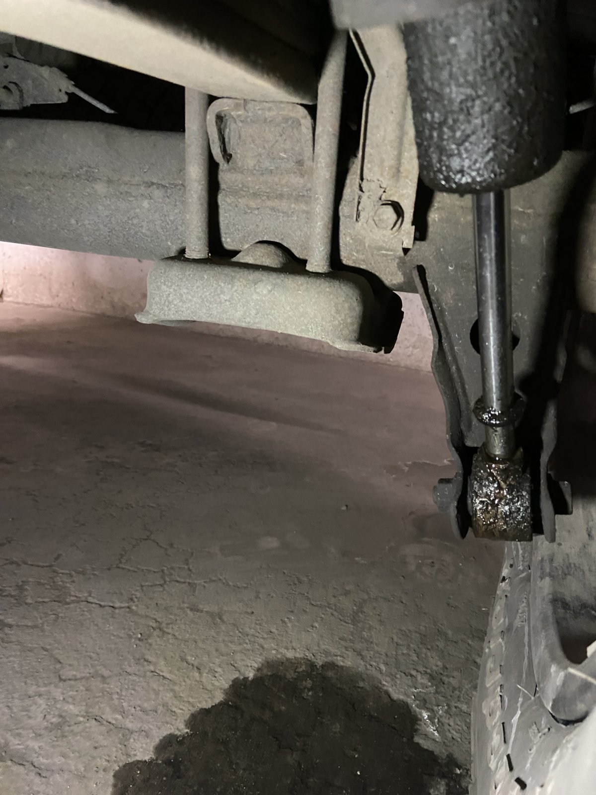

    Looks like my driver side rear strut is in fact leaking and pretty bad now, so it needs to be replaced.
    So back to the original question - any recommendations for an aftermarket replacement that would be stiffer than sock? I will end up ordering the RAS down the line but first things first, and that's to replace the rear struts. Options beside OEM or are OEM the best option?

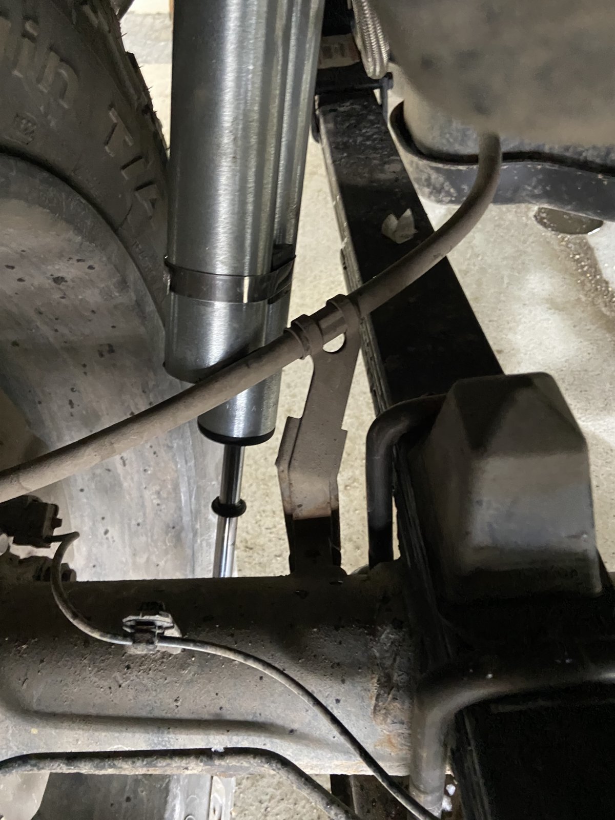

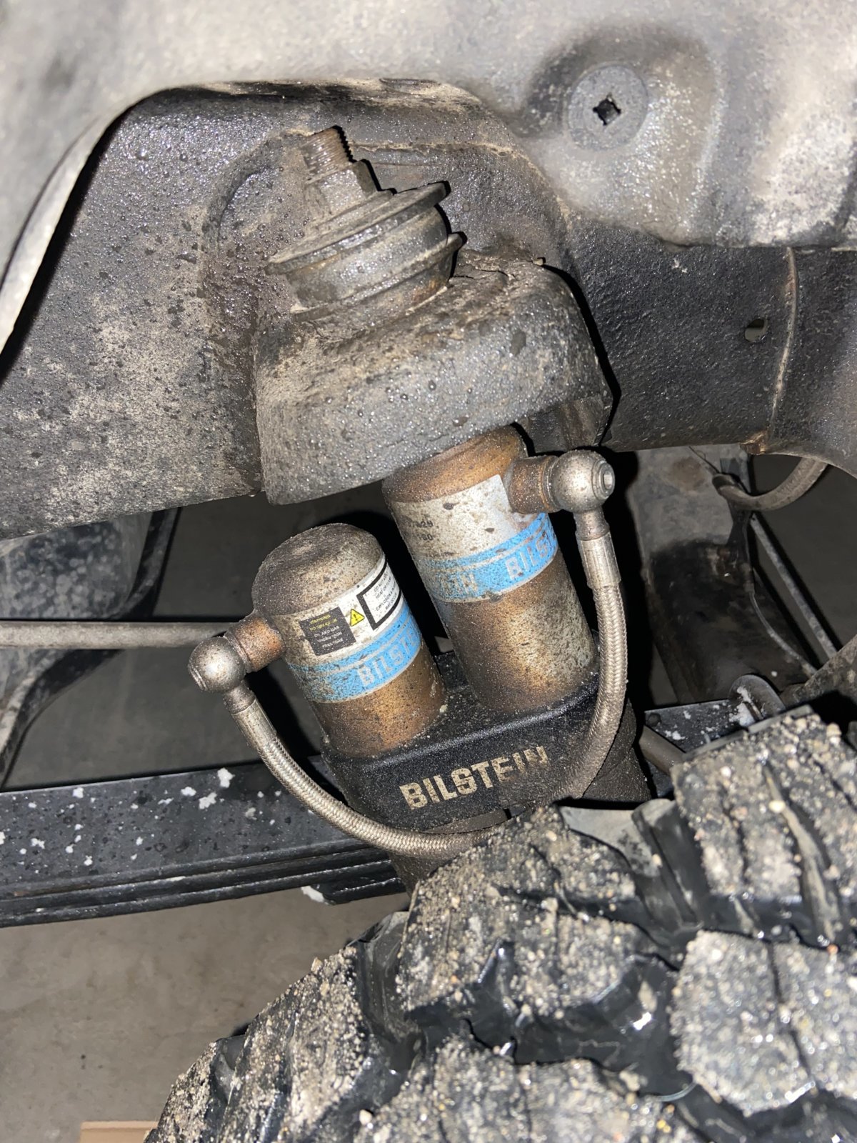

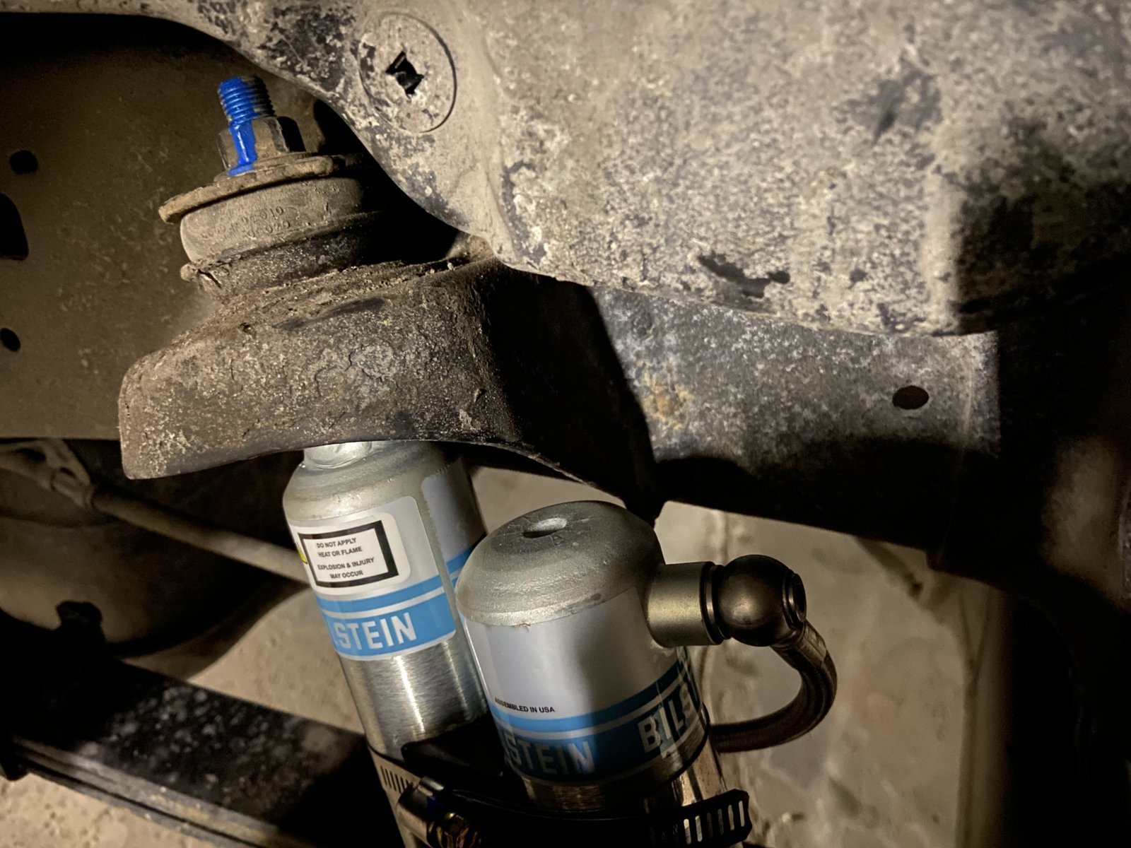

    I have 2 years of regular use with my 5160’s. Daily driving, some off-road and some travel trailer towing. Nothing at all outlandish. Also I have CB +1’s for better towing stability and reduced bed bounce. Front, 6112’s lowest setting.
    Doing it again I would not purchase the 5160’s. Instead I would just use 5100’s, for the cost, purchase 3 and you always have a spare for almost the same cost as 2 5160’s, or, just pay up for a better system rather than throw away items.
    One of the 5160’s has failed, purchased a 3 year warranty, so that’s good? Not. Going on 3 weeks to get a replacement. Store has given me every excuse as to why they haven’t received it yet. Missed loading, weather delay, it’s on the truck, nope it’s not on the truck, it’s here, nope, don’t know where the truck is. I’m just hanging and waiting.
    Tomorrow I’m ordering 2 5100’s from another shop, 2 days for shipping. Done. Total and complete waste of time for a commodity item.

    Bummer to hear that. Mine lasted 100k before one started failing. I wasn’t super gentle on them either. Judging by your pics and the little black donut o ring on the shaft, I’m guessing they might have been bottomed out which led to the failure. I’m not an expert, but I monitored that o ring to make sure I had enough spring to keep from bottoming (I run airbags so no issue adding some extra spring when needed). When I found mine to fail, it didn’t leak fluid all over either.

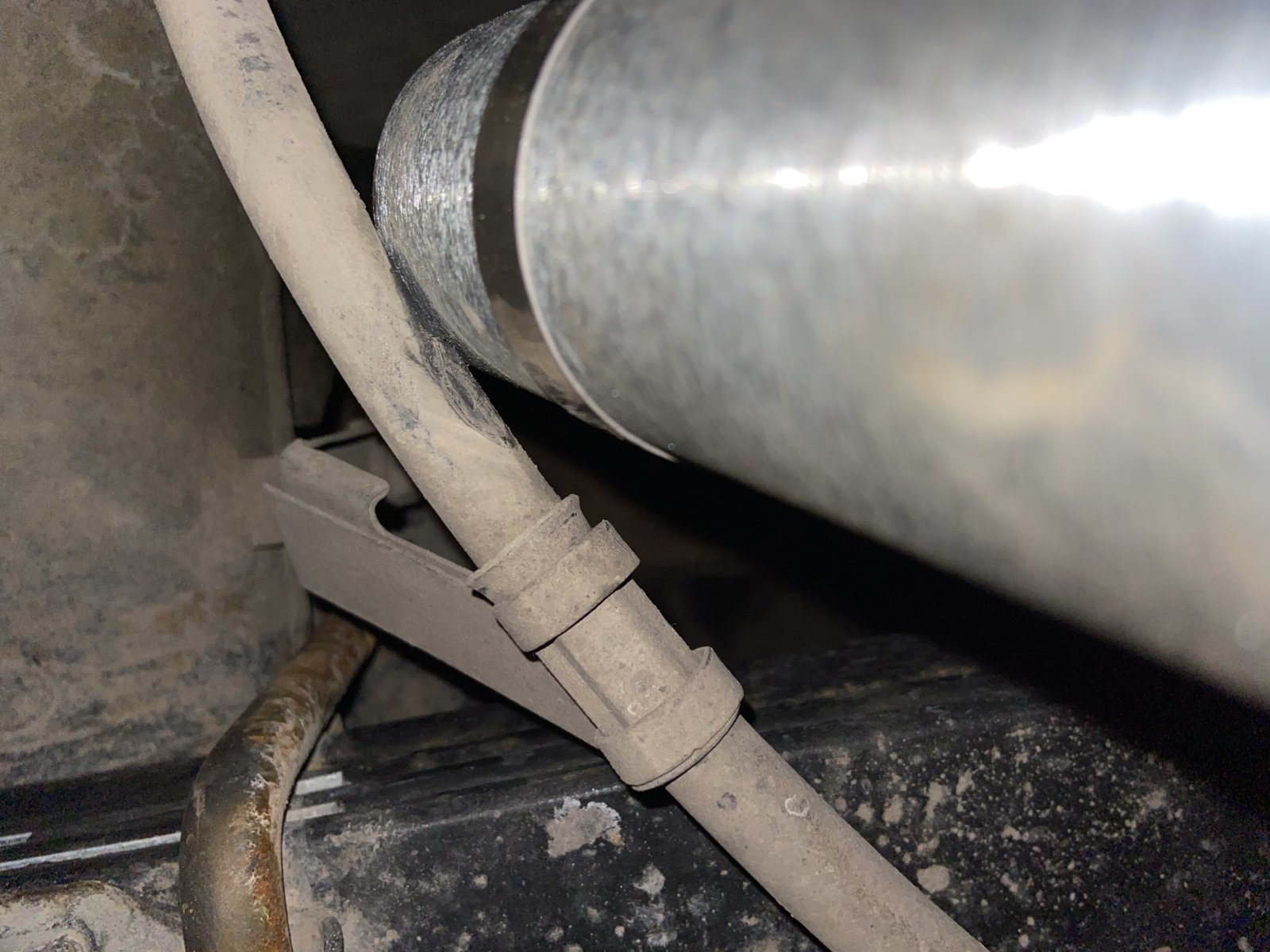

    Conclusion,
    Shop got a replacement warranty shock in late last week, offered install as well. Sure, makes my life easier. The 5100’s went on back order and it was going to be at least 2 weeks to order and receive delivery. At least the warranty came through on the 5160.
    But, the tech installed the shock backwards! I couldn’t believe it. Then, I checked everything he did. The reversed revisor had a 1/4” clearance to the frame shock mount, rookie mistake. Didn’t end there, the bottom of the revisor had cut into my emergency brake cable line because he couldn’t move it up anymore. Wonder why! Had enough, brought my truck to a Toyota dealer, explained things, got the shock checked and reinstalled, report and estimate on the brake cable within a few hours.
    Brought the invoice back to the original shop, they lied to my face about everything! The original install was like that, it’s ok that the shock is close to the mount, that’s how we do it, the emergency cable was like that! I had taken pics before and after, had Toyota’s paperwork documenting the neglect. Had Bilstein’s install instructions.
    Best part was having customers come over to the order desk listening. It was extremely embarrassing for the tech and manager to have their lies disproven with facts and documented pictures.
    I’m getting reimbursed shorty for the work I paid for. The emergency cable, I have resolved that on my own.
