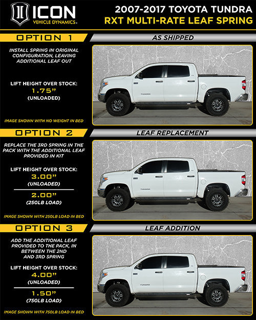

    Most common replacement springs are icon rxt, alcan, or deaver. I think alcan and maybe Deaver can make custom ones based on what you want for height and weight. For icon rxt, the more weight you want it to carry the higher it will lift.
    I have a decked and an ARE cap and probably have 400-500 lbs in the bed all the time. I got airlift airbags and usually have them at 15 psi. It carries the weight and didn’t affect the ride too much. I can also fill them when I need to carry more weight. Put them at 50 psi when I put a half ton of pellets in the bed and it handled it good.
