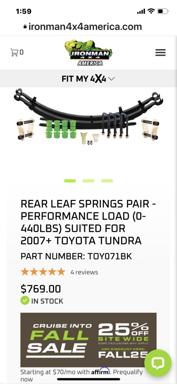

    Thanks for the advice guy's here is what I ended up doing. I found what seems like a pretty awesome deal on a set of leaf picks from Ironman 4x4 they are the 0-440 pound set +4", talked to a great guy there who helped a ton, said it would sit about 3.5" which would be perfect. Basically everything is 25% off right now FALL25 coupon code. The packs come with everything you need to install, bushings, New shackles & more $570 shipped! Maybe too good to be true but we shall see, I did read up as much as I could find on their products and they seem legit. I called Alcan & Deavers both $950 and up (just for the spring packs ) depending on what you want....figured I'd give these ironman a try for the price. I am also planning on installing some Firestone ride rite with cradles for towing. Just going to use my fabtech cheap shocks in back for now and probably the Vertex up front and see how it does. I don't usually go cheap but hey its got to be better than blocks in the back!
